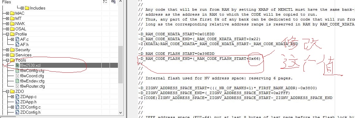

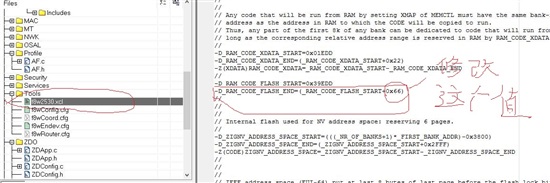

IAR 编译zstack时候出现下面的编译错误 求解 在线等
Other Parts Discussed in Thread: TIMAC, CC2650
Error[e16]: Segment RAM_CODE_FLASH (size: 0x27 align: 0) is too long for segment definition. At least 0x4 more bytes needed. The problem occurred while
processing the segment placement command "-Z(CODE)RAM_CODE_FLASH=_RAM_CODE_FLASH_START-_RAM_CODE_FLASH_END", where at the moment
of placement the available memory ranges were "CODE:39edd-39eff"
Reserved ranges relevant to this placement:
CODE:39edd-39eff RAM_CODE_FLASH
BIT:0-7 BREG
BIT:80-97 SFR_AN
BIT:a0-af SFR_AN
BIT:b8-c7 SFR_AN
BIT:d8-df SFR_AN
BIT:e8-ef SFR_AN
BIT:f8-ff SFR_AN
Error while running Linker
我的iar是8.20,以前用的还没有问题的
