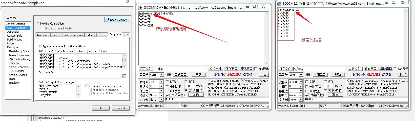

设置了终端休眠后,协调器给终端广播数据,会乱码?急救,谢谢
网络中就一个协调器和一个终端设备。
-DRFD_RCVC_ALWAYS_ON=FALSE /* The number of milliseconds to wait between data request polls to the coordinator. */ -DPOLL_RATE=1000 /* This is used after receiving a data indication to poll immediately * for queued messages...in milliseconds. */ -DQUEUED_POLL_RATE=100 /* This is used after receiving a data confirmation to poll immediately * for response messages...in milliseconds */ -DRESPONSE_POLL_RATE=100 /* This is used as an alternate response poll rate only for rejoin request. * This rate is determined by the response time of the parent that the device * is trying to join. */ -DREJOIN_POLL_RATE=440
