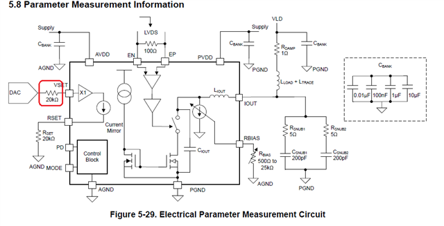

Hello,Figure 5-29. Electrical Parameter Measurement Circuit
mark 20k resistance,Does it refer to the resistance of RSET to ground or the resistance connected in series with VSET PIN?
Part Number: LMH13000RQEEVM
Hi,
Please refer to datasheet 19 page “The VSET voltage is applied using a DAC through a 20kΩ series resistor.”
Thanks for your reply!

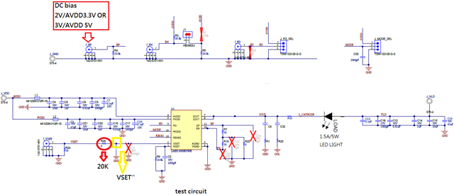

Hello,According to the suggestion:"datasheet 19 page “The VSET voltage is applied using a DAC through a 20kΩ series resistor.",
Setting conditions:
single-ended input;DC bias 2V/AVDD 3.3V OR 3V/AVDD 5V
(PD = 0);(MODE = 1);(RBIAS=1);High-Current Mode
The iout current is locked and cannot be controlled by VSET,VSET'' voltage is locked 3.7V
OR(PD = 0);(MODE = 0);(RBIAS=1);Low-Current Mode
The iout current is also locked and cannot be controlled by VSET,VSET'' voltage is locked 2.1V
Is there a problem with the circuit wiring method or design parameters, or is the development board damaged?
