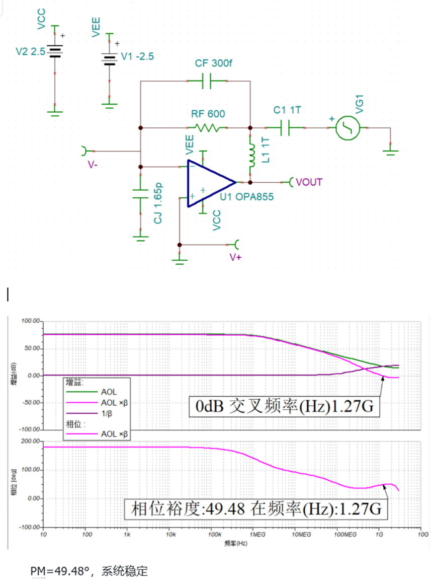

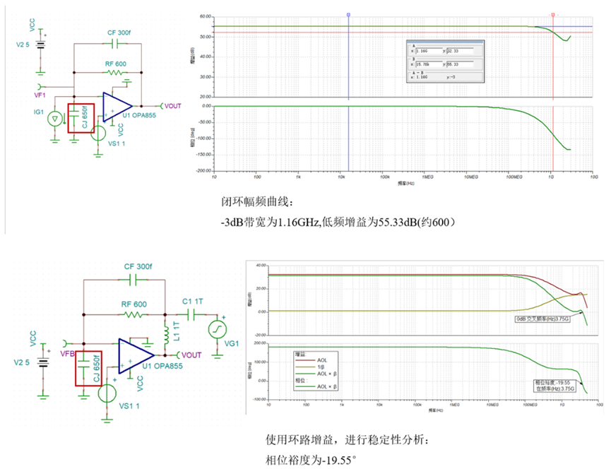

Hello. I am currently designing a 1 GHz-bandwidth transimpedance amplifier (TIA) and plan to implement it using the OPA855 operational amplifier together with a photodiode whose junction capacitance is 0.65 pF. I have carried out simulations in TINA, but I have encountered several points of confusion during the process.
I would sincerely appreciate it if you could offer me some guidance or suggestions. Thank you very much for your time and support.
My questions are as follows:
(1) Initially, I assumed that the OPA855 model already included the input capacitance, so I set CJ to represent only the photodiode junction capacitance of 0.65 pF. Under this condition, the AC analysis showed a bandwidth of 1.13 GHz, but the phase margin was only –20°.
I then increased the capacitance at the junction node to 1.65 pF. With this change, the bandwidth became 1.11 GHz, while the phase margin improved significantly to 50°.
Could you please explain the reason for this behavior?
(2) If the PCB is fabricated according to the schematic I provided, is this design feasible from an engineering perspective? As far as I understand, the parasitic capacitance and inductance of the PCB will significantly affect a transimpedance amplifier. In addition, the capacitance values of 0.3 pF and 1.65 pF are extremely small—especially 0.3 pF. How can such small capacitances be realized in practical hardware?
(3) If my current component selection is not appropriate, I would appreciate any suggestions you could offer.
(4) Is it feasible to achieve a 1 GHz-bandwidth transimpedance amplifier through careful design?
Thanks.

    1. Your thought process here is correct, and the values you have chosen are also the same ones from our TIA calculators for 600Ohm feedback resistor and 0.65pF input photodiode capacitance. The OPA855 model will have the internal capacitance modelled. The reason why increasing the capacitance further at the input stabilizes the circuit is because this amplifier is decompensated. The OPA855 is stable for gains of 7V/V or greater. In a regular voltage feedback amplifier configuration, you would set RF and RG to set the gain to 7V/V or greater. For a TIA, this occurs naturally since noise gain will be 1+C_total_Input/C_Feedback
      With 0.65pF, this would be 1 + 1.4pF/0.3pF = 5.6V/V. When increasing your external input capacitance to 1.65pF, this would be 1 + 1 + 2.4pF/0.3pF = 9V/V.
      You could add an external capacitor to the input to stabilize the circuit, or you can decrease your feedback capacitor. Both of these would affect bandwidth.
    2.  Agreed that PCB layout for these high speeds will need very careful PCB design and planning. The usual max possibility to go down to is 0.1pF. The input capacitance will be internal to the photodiode capacitance. We highly recommend adding a DNP (do not place) input capacitance to ground as well at the input of the amplifier for above 1) reason. I have seen methods to decrease feedback capacitance using capacitive t-networks
      However, when I have seen this implemented, I have seen issues come from this network with increase instability. Therefore, I recommend just placing two series capacitors instead in the feedback with trace length as short as possible. And, of course a separate GND and PWR plane underneath and these planes cutoff right under the input/feedback traces at the amplifier to minimize capacitive parasatics.
    3. My suggestion is to keep the components but add the DNP input capacitance to ground to add more input capacitance rather than decreasing the feedback capacitance to obtain the required gain for stability. This will decrease bandwidth, but you may be able to achieve 1GHz with tuning.
    4. It will be difficult and will require very careful PCB planning, but it may be possible based on calc/sims. When PCB layout is done, we can help review it, and I would recommend importing the layout to a simulator that calculates parasatics/impedance. We use Ansys on our end.

  • Thank you very much for your detailed reply and valuable suggestions. After careful consideration and self-review, I have two further questions and would greatly appreciate your guidance.
    (1)From a design trade-off and risk-mitigation perspective, would you recommend populating a fixed external input capacitor (e.g., 1 pF to ground) at the inverting input by default in order to explicitly satisfy the OPA855 minimum stable noise-gain condition (≥ 7 V/V), or is it generally preferable to reserve a DNP input capacitor footprint to ground and populate it only if instability is observed during bench testing?
    In my design, the PCB uses a four-layer stackup (TOP – GND – POWER – BOTTOM), and both the GND and POWER planes have been completely cleared beneath the inverting input node. As a result, the parasitic capacitance associated with a DNP input capacitor footprint is expected to be minimal. Under these conditions, would the DNP-only approach be considered sufficiently robust for first-pass hardware, or would pre-populating the input capacitor still be advisable for margin?
    (2)I will upload my PCB design files for your review. I would appreciate it if you could examine the layout and provide comments or recommendations. In the current PCB layout, neither a populated 1 pF external input capacitor nor a DNP input capacitor to ground is included.
    I look forward to your response.

      Yes, I agree, you can just add the fixed external input capacitor of 1pF at the inverting pin by default, and during testing you can remove or tune if needed. This way you will satisfy the theoretical calculations for OPA855 min stable noise gain of ≥ 7V/V.
      Yes, your 4-layer approach is correct. There could be still parasitic capacitance, but due to the cut-off of the inner planes, I agree to keep the default 1pF input capacitance for margin.
