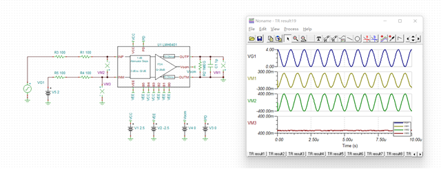

Lmh6401 was used in my design, Now during the simulation, I found that the common-mode voltage at the input end of P&N is being attenuated.
Now I have two questions:

LMH6401 Common.TSC this is my simulation

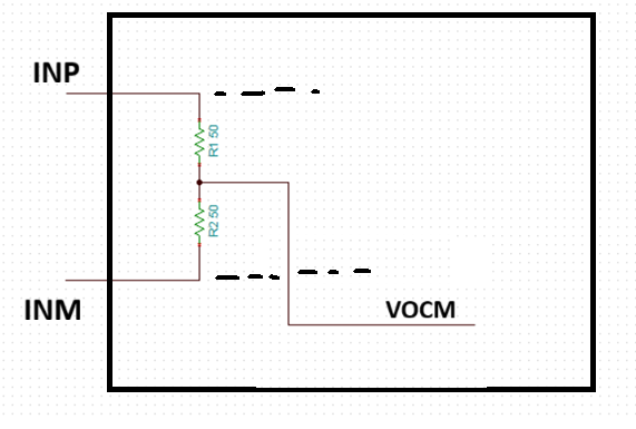

Hi,
The input stage of the LMH6401 looks something like below:-
If VOCM is zero like in your case, the single ended input impedance will be 50ohm and hence you input common mode voltage will get attenuated by a factor of 5 (resistive divider formed by 200ohm (R4+R5 for INM) and 50hm internal to device).
