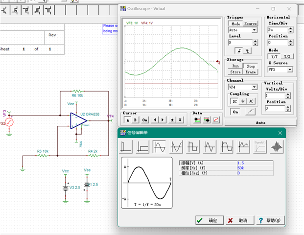

OPA838: Why is the range of the input signal in my simulation not quite the same as that in the manual?
Part Number: OPA838
Here's my schematic why I can't output a properly amplified signal when the input signal amplitude is 1.5V.
When I input a signal amplitude of 1.2V it is ok. And according to the info in the manual a 1.5V signal is not outside the normal operating range.
  • 您好
    感谢您提出此问题。 我正在研究它。 只想了解一下您对电路及其应用想要实现什么目标、因为它不是标准反相或非反相放大器。 此外、您是打算将 OPA838置于正反馈中、还是希望对同相输入进行偏置?
  • 您好
    感谢您的热心解答,我想要利用运放来实现负阻的效果,将其用于正反馈来减缓输入谐振信号的衰减。
