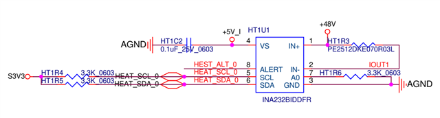

I2C shunt voltage is the same, current reading is 0
Hi,
Can you please elaborate what you meant by “shunt voltage is the same”? Can you read back any value?
For current, you’d need to program the Calibration register before it returns nonzero values.
