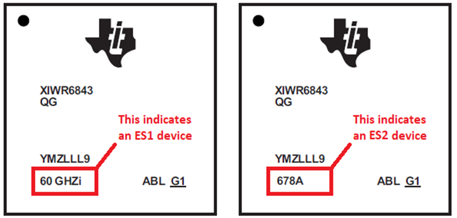

  • 请确认demo所支持的版本与芯片版本匹配,4.0.1的toolbox支持的是2.0的芯片版本的。如果是1.0的芯片,可以使用老版本的toolbox
    IWR6843 ES2.0 Only
    This lab is only compatible with ES2.0 version of IWR6843. Check the device version on your IWR6843ISK using the on-chip device markings as shown below>
    1. If line 4 reads 678A, you have an ES2 device. In this case, this lab is compatible with your EVM.
    2. If line 4 reads 60 GHZi, you have an older ES1 device. In this case, the lab is NOT compatible with your EVM. ES2 IWR6843ISK boards are orderable from the EVM link above.
  • 你好!!
    开发板是上周采购的,已经确认IWR6843芯片上的信息,板上芯片信息如下
    第一行:XIWR6843
    第二行:QG
    第三行:97ZD4C9
    第四行:678A   ABL  G1
    确认开发板是ES2 device
