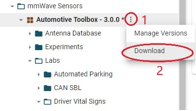

另外:按照你所提供的信息,下载mmwave sensor的3.0.0版本时候,其代码是不可用的,出错信息如下:
Error communicating with cloud agent
REFRESHt: Could not get agent, make sure to check if the agent is installed before calling this component at P (dev.ti.com/.../bundle.js:14:29348) at b (dev.ti.com/.../bundle.js:14:26379) at l (dev.ti.com/.../bundle.js:21:114957) at dev.ti.com/.../bundle.js:21:109272 at sa (dev.ti.com/.../bundle.js:78:59331) at Va (dev.ti.com/.../bundle.js:78:66684) at jc (dev.ti.com/.../bundle.js:78:106601) at ml (dev.ti.com/.../bundle.js:78:90017) at dl (dev.ti.com/.../bundle.js:78:89942) at il (dev.ti.com/.../bundle.js:78:87290)
in ForwardRef in div in ForwardRef in div in ForwardRef in ForwardRef in div in t in ForwardRef in Te in div in ForwardRef in ForwardRef in ForwardRef in ForwardRef in div in ForwardRef in div in div in ForwardRef in ForwardRef in ForwardRef in ForwardRef in a in ForwardRef in ForwardRef in ForwardRef in td in ForwardRef in ForwardRef in tr in ForwardRef in ForwardRef in ForwardRef in tbody in ForwardRef in ForwardRef in table in ForwardRef in ForwardRef in div in div in ForwardRef in ForwardRef in div in ForwardRef in ForwardRef in ForwardRef in ForwardRef in div in t in ForwardRef in t in ForwardRef in div in Unknown in ForwardRef in ForwardRef in ForwardRef in div in div in div in ForwardRef in t in t in t in ForwardRef in ForwardRef in ForwardRef in Unknown in ForwardRef in g in r in div in div in ForwardRef in t in t in t in t in Unknown in t in Unknown

非常感谢您的详细信息。 是的,我是这么操作。已经下载了数据包。使用3.0.0版本的host 软件和target的bin文件。AWR1642 boostEVM已经可以正常工作。在下载“\labs\lab0001-driver-vital-signs\vitalSigns_target”之后,里面的DSS和MSS文件夹内只有source code 而可能缺乏工程文件。这个是否是导致在CCS IDE界面内直接导入工程出错的原因?
你好,
请参考lab 的release note信息,下载正确版本的mmwave sdk软件,然后就可以正常编译CCS工程了。
