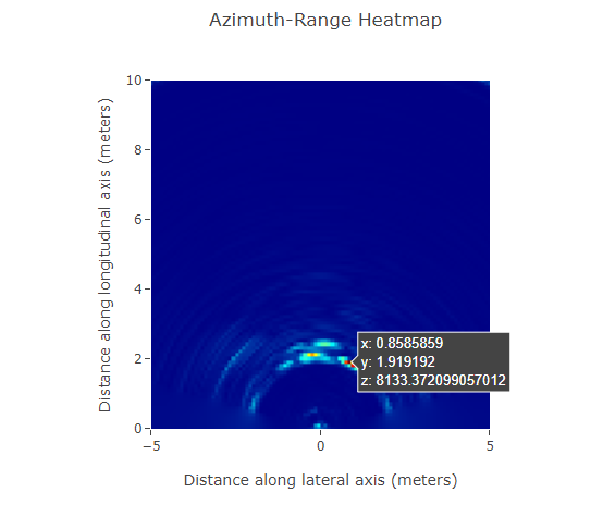

<rangeAzimuthHeatMap> or <rangeAzimuthElevationHeatMap>
range-azimuth or range-azimuthelevation heat map related information
This output is provided only in demos that use AoA (legacy) DPU for AoA processing
1 - enable export of zero Doppler radar cube matrix, all range bins, all azimuth virtual antennas to calculate and display azimuth heat
map. (The GUI computes the FFT of this to show heat map)
0 - disable
< rangeAzimuthElevationHeatMap >
This output is provided in demos that use AoA 2D DPU for AoA processing (ex: mmW demo for IWR6843AOP)
1 - enable export of zero Doppler radar cube matrix, all range bins, all virtual antennas to calculate and display azimuth heat map.
(The GUI remaps the antenna symbols and computes the FFT of this stream to show azimuth heat map only).
0 - disable
<rangeDopplerHeatMap>
range-doppler heat map
1 - enable export of the whole detection matrix. Note that the frame period should be adjusted according to UART transfer time.
0 - disable
