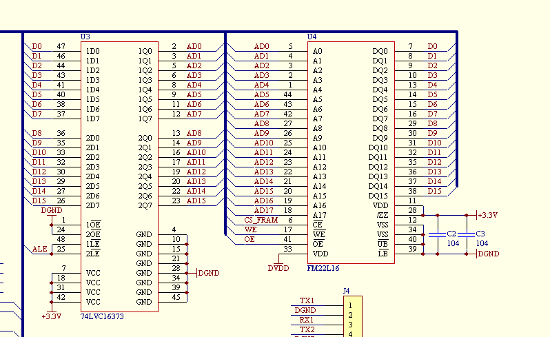

LM3S9B92 通过EPI外接 铁电SRAM FM22L16 读写数据有问题想大家请教

//================== EPI配置 ===================
EPIModeSet(EPI0_BASE, EPI_MODE_HB16); //Flash + SRAM使用HB8模式
EPIDividerSet(EPI0_BASE, 1); //波特率等于系统时钟/2
EPIConfigHB16Set(EPI0_BASE,
                EPI_HB16_MODE_ADMUX | //使用ADMUX子模式,地址/数据总线复用子模式
                EPI_HB16_WRWAIT_0   | //无写等待态
                EPI_HB16_RDWAIT_0   | //无读等待态
                EPI_HB16_WORD_ACCESS| //使用字访问模式
                EPI_HB16_CSCFG_ALE , //使用ALE配置,EPI0S30用作ALE,EPI0S26、27则由访问的地址确定
                   0); //无使用FIFO,无需设置
EPIAddressMapSet(EPI0_BASE,
                 EPI_ADDR_RAM_SIZE_16MB | //设置片外SRAM空间为16MB
                 EPI_ADDR_RAM_BASE_6); //设置自外SRAM的映射空间基地址为0x60000000
   while(HWREG(EPI0_BASE + EPI_O_STAT) &  EPI_STAT_INITSEQ)
HWREGH(0x60000000)=0x0000;
HWREGH(0x60000001)=0x1111;
HWREGH(0x60000002)=0x2222;
HWREGH(0x60000003)=0x3333;
HWREGH(0x60000004)=0x4444;
HWREGH(0x60000005)=0x5555;
//HWREGH(0x60000002)=0x2222;
a=HWREGH(0x60000000);
b=HWREGH(0x60000001);
c=HWREGH(0x60000002);
d=HWREGH(0x60000003);
e=HWREGH(0x60000004);
f=HWREGH(0x60000005);
c=HWREGH(0x60000004);
   while(1)
读出的数据不对!!!!!!
