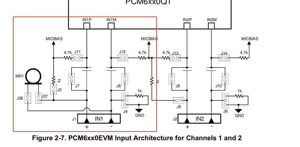

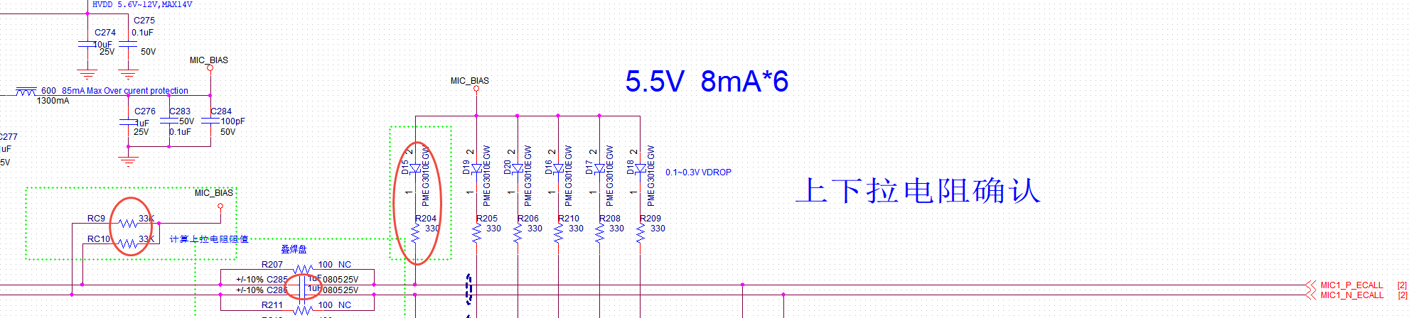

您好,
1.请问AC耦合电容如何选择;
2.MIC1通道AC耦合输入MIC信号,请根据PCM6xx0Q1EVM-PDK Evaluation Module (Rev. B) 的案例1介绍下,当MK1输入,输入电路为AC耦合接法时,J36/J37/J3/J4-GND/J11/J12 installed ,J7/J8 uninstalled。接法是否正确?
3.帮忙check所对应的原理图,红框部分为焊接元器件。
请关注:1.MIC供电方式;2.AC耦合输入的接法。

1) Coupling cap value is chosen based off the high pass filter formed by the AC cap + input impedance R.
2) yes you are correct. Refer to table 2-1 for the table on jumper configurations for various scenarios.
3) Schematic looks okay. Remember for layout to connect the MICBIAS star as close to the device pin as possible to reduce any cross-talk through the MICBIAS node.

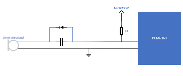

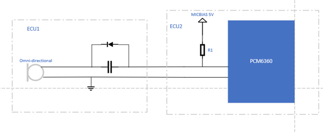

我已经提供了如何设计ECU2的指导。另请参阅数据表中的应用程序图。
The AC coupling cap is required on both legs as well as the MICBIAS resistor to provide bias to the ADC input pins. Check the diagrams in the data sheet for references on this.There is a link in the datasheet to a tool that will help you calculate R1.
