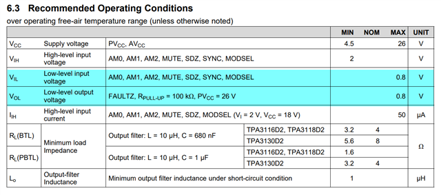

From 7.3.10 section,
如果功放输出短路,那短路就会保护并锁死,如果要能自动恢复,那将FAULTZ pin与SDZ pin连在一起,出现的问题是FAULTZ pin上拉1K电阻,输出短路不会恢复,上拉100K电阻才可能,
想知道为什么上拉1K电阻不行.
  • 您好,
    1K电阻时是不能拉至0.8V以下是吗?如果是这样的话,那应该是FAULTZ pin内部晶体管导通电阻太大的缘故。FAULTZ pin是OD输出,内部晶体管导通时输出低电平,如果其导通电阻太大,与外接的上拉电阻分压就会偏高,使得其输出低电平不满足SDZ pin输入规格:
  • thank you very much for the quickly reply.  yeah, 1k pull up doesn't pull the voltage of the SDZ to less than 0.8v. i have changed the pull up to 100k, then it worked well.
