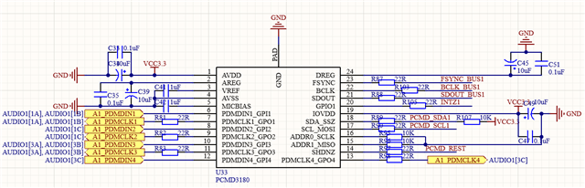

register config in next picture.
and i read from state register.
i config I2S bclk is 48000hz and bclk/FSYNC is 64,reg 0x15 = 0x44 is correct.
is there something wrang in reg config?
please give me some advise.

The device configuration script seems to be correct.
1) Can you also check the status of the two interrupts in the INT_LTCH0 register?
2) Is there no PDMCLK seen when probing the PDMCLK pins of the PCMD3180 on a scope?
3) Is this systematically seen on multiple PCBs?
