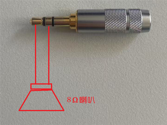

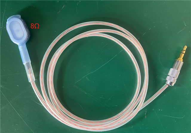

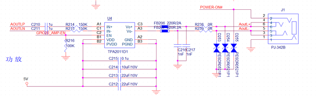

In our device, we use TPA2011D as AMP, and the output connect a 3.5mm Phone Jack to 8Ω speaker.
We found when we remove the phone jack from connector, it will cause a momentary short circuit between AMP output L+/L-. And then TPA2011D broken down.
In the datasheet, TPA2011D has Auto-Recovering Short-Circuit Protection, but why TPA2011D broken down?
