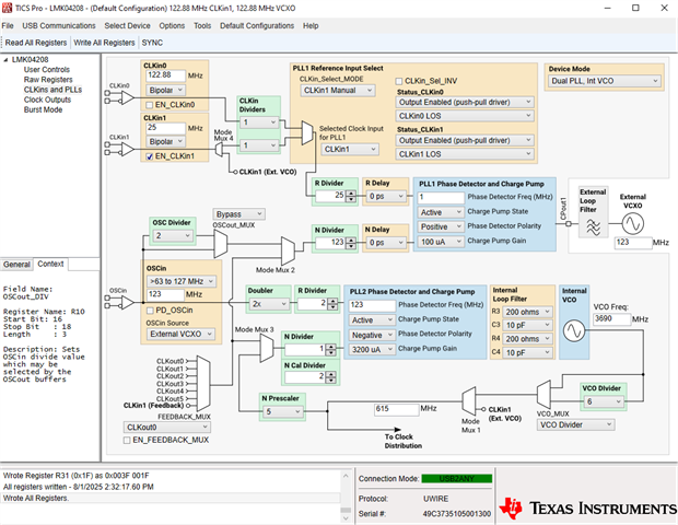

I configured the LMK04208EVM evaluation board with the following settings, but found that there is a deviation between the actually measured clock and the clock displayed in the TICS Pro software.

test result
oscout=122.85MHz
clkout0=107.29MHz
clkout1=26.8MHz
clkout2=107.29MHz
clkout3=107.29MHz
clkout4=30.721MHz
clkout5=107.29MHz
All measured values show deviations from the theoretical values except for CLKOUT4.
When configured on our own development board, there is no clock output from CLKOUT0 to CLKOUT5.
I feel very strange, hope your response as soon as possible. Thanks!
