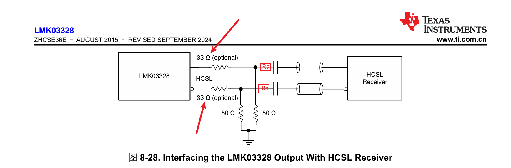

LMK03328: LMK03328输出HCSL时Rs电阻咨询
Part Number: LMK03328
您好!说是Rs可用于限制由于快速瞬态电流引起的过冲和振铃 ,那么请问放在50欧偏置电阻后面不行吗?谢谢!

    The HCSL output structure is open-drain and can be direct coupled or AC coupled to HCSL receivers with appropriate termination scheme. This output structure supports either on-chip 50-Ω termination or off-chip 50-Ω termination. The on-chip, 50-Ω termination is provided primarily for convenience when driving short traces. In the case of driving long traces possibly through a connector, the on-chip termination must be disabled and a 50 Ω to GND termination at the receiver must be implemented. The output supplies can be operated from 1.8 V, 2.5 V, or 3.3 V without any impact on jitter performance or other AC or DC specifications. The LVCMOS outputs on each side (P and N) can be configured individually to be complementary or in-phase or can be turned off (high output impedance). The LVCMOS outputs are always at 1.8-V logic level irrespective of the output supply. In case 3.3-V LVCMOS outputs are required, STATUS1 and/or STATUS0 can be configured as 3.3-V LVCMOS outputs.
    33Ω放在图示位置是为了实现源端端接,确保信号进入传输线前阻抗已经匹配。而 Rs 的位置通常是为进一步微调信号质量或在特定的交流耦合需求下预留的,两者功能不同。
