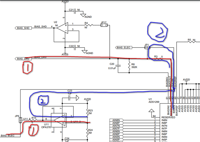

I tried two sources for BIAS_DRV you mentioned in last related question, that is BIASREF_INT be set 0 or 1.
I found that these two ways has roughly equivalent common mode rejection function for 50Hz sine wave.
At the same time, I read in slau443b page 34 that, The advantage of using BIAS_DRV signal is that it takes advantage of feedback loop to get better common mode rejection.
Now is my question, is "BIASREF_INT be set 1" way tests much more better or just a little better?
