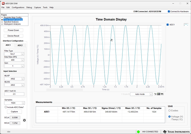

Can you tell me how the signal is being applied to the EVM? It looks like there could be a common-mode issue
The 1VPP signal should be centered in the ADC supply range. If you are using 5V unipolar supplies, then the signal should be centered at 2.5V
Also, you in general need to ensure you are taking enough samples per period to get a good recreation of the waveform. For example, measuring a 1 Hz sinewave at 5SPS will not be sufficient to adequately reproduce the sinewave
You should also consider the 3dB cutoff frequency of the filter you are using. This will attenuate the response. Refer to Table 9-4 in the ADC datasheet for more information

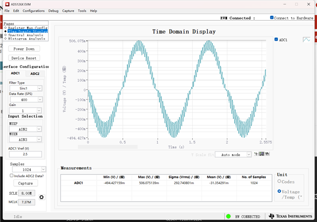

We are using a signal generator which emits a sinusoidal signal with a frequency of 1 Hz or 1 KHz, a peak-to-peak value of 1 V, and without any offset. So the waveform collected by ADS1263 is one that oscillates up and down around 0. What puzzles me is that when a 1KHz sine wave with a peak-to-peak value of 1V is input, why does the amplitude of the collected signal fluctuate so greatly? It is still rather strange as to why, when a 1Hz peak-to-peak 1V sine signal is input, the waveform obtained with an excessively high sampling rate is of poor quality. These two questions
The ADS1263EVM does not support bipolar supplies, which means a signal centered at 0V will be outside the ADC common-mode range. Ideally the sinewave should be centered at 2.5V as I stated in my previous post.

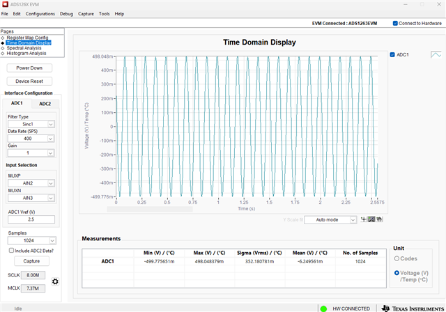

You can see this in the image below, also from the EVM. We are using the same settings as you and the sinewave output looks very good
So you have the signal applied incorrectly to the ADC somehow

Yes, this is correct and what we did to obtain the sinewave shown in the image I sent you

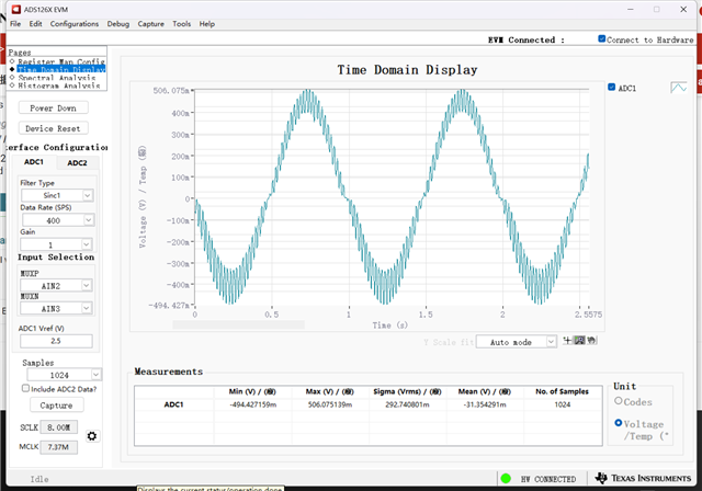

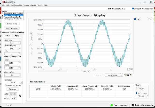

我按照您的方法采集到的波形是下边这个样子的,请问是我这边干扰太大了吗,还是接地工作没做好。
I would like to ask, the waveform I captured looks like this. Is it because there is too much interference on my side, or is the grounding not done properly?

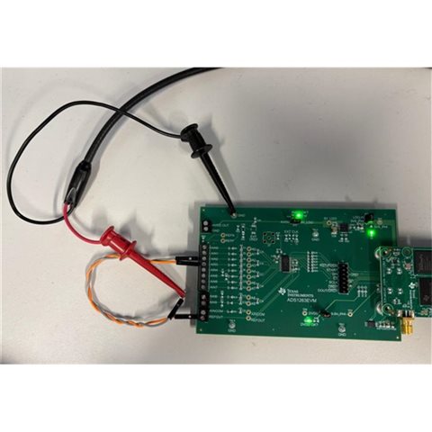

Could you please show me how the hardware of your ADS1263EVM is connected? Just like what I captured above.
Yes it looks like you are picking up another signal, maybe 60Hz?
It does also look like you are getting a discontinuity as the sinewave crosses 0, so there might still be grounding issues as well
This is a 1Hz sine wave with a peak-to-peak value of 1V. You mentioned that there was a problem with the grounding. You were able to obtain a complete waveform on the upper side at that time. How was the EVM set up and connected?
In general, you are making sure that the ADC ground and the signal source ground are shared
Then you need to ensure the sinewave has a 2.5V DC offset
Of course if you are picking up other signals e.g. 60Hz then you will need to remove those / filter them out somehow

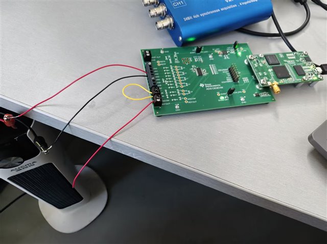

Could you please show me the connection method of the ADS1263EVM circuit on your side? I'd like to take a look at the picture.

Dear Engineer, I would like to ask, is this supposed to be the single-ended input connection method? How should the differential input be connected?
