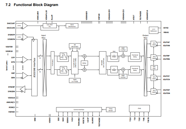

Could you please clarify the following points?
1. What is the expected latency from the DAC37J82 JESD serial input to the
   analog output for the configuration listed above?
2. Which internal blocks contribute to this latency, and how many DACCLK
   or frame-clock cycles does each block contribute?
3. Is there an elastic buffer, JESD receive FIFO, synchronization stage or
   common digital pipeline after the SerDes/8b10b block that contributes
   significant latency?
4. Can this FIFO or digital pipeline be bypassed or configured for minimum
   latency while retaining JESD204B Subclass 1 deterministic latency?
5. Does the documented 11-DACCLK-cycle latency apply to this exact
   configuration with interpolation, PAP, mixer, QMC and inverse-sinc
   disabled? If so, from which internal reference point to which output
   point are those 11 cycles defined?
6. Which internal blocks are shared by the SIFDAC path and the normal
   JESD204B sample-data path?
7. Does a SIFDAC response of approximately 150 DACCLK cycles indicate a
   normal register-update synchronization delay, or does it indicate the
   latency of a shared DAC digital-output pipeline?
8. Is there a recommended register configuration or test method for
   measuring the minimum deterministic JESD-input-to-analog-output latency
   of the DAC37J82?
Our primary concern is the approximately 250 to 260 ns total
trigger-to-analog-output latency. The SIFDAC measurement is only an
additional observation that may help identify where the unexpected delay
is introduced.
