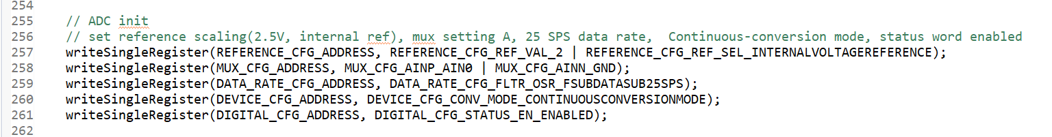

MCU: MSPM0G3507
ADC: ADS122S14
problem:The initialization using the DEMO program can communicate with the ADC. However, after modifying the initialization, I was unable to communicate with the ADC, and even when I used the DEMO program for initialization again, I still couldn't communicate with the ADC. Has the ADC failed?I need design a three-wire PT100 RTD measurement and two IDAC current source.Could you please help me analyze what caused this?
demo progrom:
my progrom:

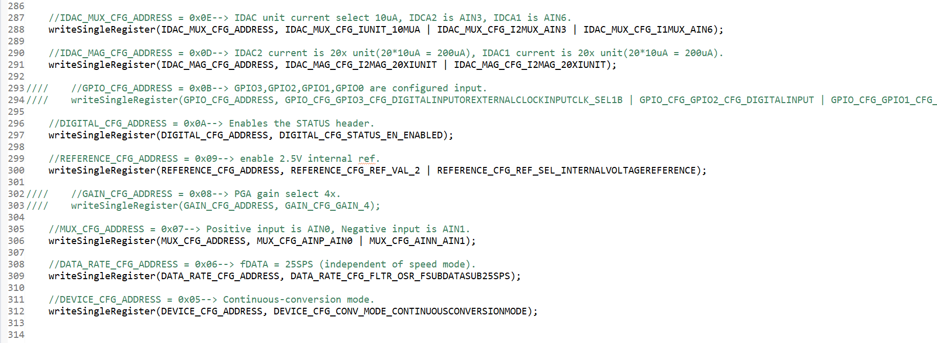

  • I found that by enabling only IDAC1, the communication seems to be working properly.
  • 	//IDAC_MUX_CFG_ADDRESS = 0x0E--> IDAC unit current select 10uA, IDCA1 is AIN6.
    	writeSingleRegister(IDAC_MUX_CFG_ADDRESS, IDAC_MUX_CFG_IUNIT_10MUA | IDAC_MUX_CFG_I1MUX_AIN6);
    	//IDAC_MAG_CFG_ADDRESS = 0x0D--> IDAC1 current is 90x unit(90*10uA = 900uA).
    	writeSingleRegister(IDAC_MAG_CFG_ADDRESS, IDAC_MAG_CFG_I1MAG_90XIUNIT);
    	//DIGITAL_CFG_ADDRESS = 0x0A--> Enables the STATUS header.
    	writeSingleRegister(DIGITAL_CFG_ADDRESS, DIGITAL_CFG_STATUS_EN_ENABLED);
    	//REFERENCE_CFG_ADDRESS = 0x09--> enable REF buffer.
    	writeSingleRegister(REFERENCE_CFG_ADDRESS, /*REFERENCE_CFG_REFP_BUF_EN_ENABLED |*/ REFERENCE_CFG_REF_VAL_2);
    	//MUX_CFG_ADDRESS = 0x07--> Positive input is AIN0, Negative input is AIN1.
    	writeSingleRegister(MUX_CFG_ADDRESS, MUX_CFG_AINP_AIN0 | MUX_CFG_AINN_AIN1);
    	//DATA_RATE_CFG_ADDRESS = 0x06--> fDATA = 25SPS (independent of speed mode).
    	writeSingleRegister(DATA_RATE_CFG_ADDRESS, DATA_RATE_CFG_FLTR_OSR_FSUBDATASUB25SPS);
    	//DEVICE_CFG_ADDRESS = 0x05--> Continuous-conversion mode.
    	writeSingleRegister(DEVICE_CFG_ADDRESS, DEVICE_CFG_CONV_MODE_CONTINUOUSCONVERSIONMODE);
    this is my progrom.
