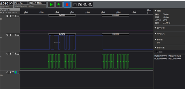

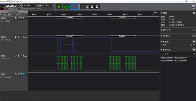

    However, when I read the converted value from the ADS8699 using the following function, the result is always around 6.2V, while the actual input voltage is -4.8V:
    c复制
    uint32_t Read_ADS8699(void) {
        uint32_t command = 0xC8000000;  // Command to read data register (address 0x00)
        uint8_t tx_buffer[4];
        uint8_t rx_buffer[4];
        tx_buffer[0] = 0x00;
        tx_buffer[1] = 0x00;
        tx_buffer[2] = 0x00;
        tx_buffer[3] = 0x00;
        // CS low, start communication
        HAL_GPIO_WritePin(SPI_CS_GPIO_Port, SPI_CS_Pin, GPIO_PIN_RESET);
        HAL_SPI_TransmitReceive(&hspi1, (uint8_t*)tx_buffer, (uint8_t*)rx_buffer, 4, HAL_MAX_DELAY);  // Transmit and receive data
        uint32_t data = rx_buffer[0] << 24;
        data |= rx_buffer[1] << 16;
        data |= rx_buffer[2] << 8;
        data |= rx_buffer[3];
        data = (data & 0xfffc0000) >> 14;  // Extract the 18-bit data
        // CS high, end communication
        HAL_GPIO_WritePin(SPI_CS_GPIO_Port, SPI_CS_Pin, GPIO_PIN_SET);
        return data;
    I'm not sure why the reading is incorrect. Can you help me identify the issue?

  • Using the STM32L431 chip, the ADS8699 is configured with a voltage range of ±5.12V. The following two screenshots from the logic analyzer show +5V and -5V inputs, respectively. However, the converted results seem to be incorrect.
  • Can you please supply the o'scope or logic analyzer plot that was asked for?
