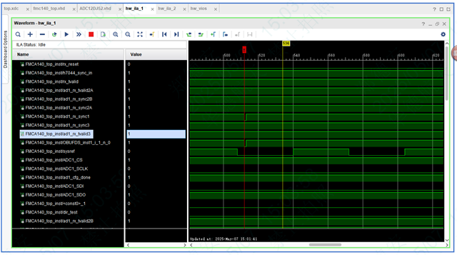

ADC12DJ5200RF: ADC12DJ5200RF配置后同步SYNC不稳定问题
Part Number: ADC12DJ5200RF
Other Parts Discussed in Thread: ADC12DJ3200
你好
我在使用ADC12DJ5200芯片时,遇到SYNC有概率性拉低问题,请协助解决一下该问题,谢谢
我使用的配置是mode19;采样率9.6G,核时钟300M,线速度12G,sysref 18.75M;
配置如下;请查看配置是否有异常,谢谢

NEED_DELAY <= x"0000000000000000";
BIR <= '0';
when x"55" =>
ad_config_reg <= x"0215" & x"00"; -- select the active NCO
BIR <= '0';
when x"56" =>
ad_config_reg <= x"0216" & x"02"; -- Digital channel input select
BIR <= '0';
when x"57" =>
ad_config_reg <= x"0217" & x"00"; -- 2-bit NCO frequency word
BIR <= '0';
when x"58" =>
ad_config_reg <= x"0218" & x"00"; -- 2-bit NCO frequency word
BIR <= '0';
when x"59" =>
ad_config_reg <= x"0219" & x"02"; -- initialize the NCO phase
BIR <= '0';
when x"5A" =>
BIR <= '0';
when x"5B" =>
ad_config_reg <= x"0220" & x"C0"; -- NCO Frequency
BIR <= '0';
when x"5C" =>
ad_config_reg <= x"0221" & x"00"; -- NCO Frequency
BIR <= '0';
when x"5D" =>
ad_config_reg <= x"0222" & x"00"; --NCO Frequency
BIR <= '0';
when x"5E" =>
ad_config_reg <= x"0223" & x"00"; -- NCO Frequency
BIR <= '0';
when x"5F" =>
ad_config_reg <= x"0224" & x"00"; -- NCO Phase
BIR <= '0';
when x"60" =>
ad_config_reg <= x"0225" & x"00"; -- NCO Phase
BIR <= '0';
when x"61" =>
ad_config_reg <= x"02B0" & x"00"; -- SYSREF Calibration ;Program SRC_CFG before setting SRC_EN. Ensure that ADC calibration is not currently running before setting SRC_EN.
BIR <= '0';
when x"62" =>
ad_config_reg <= x"02B1" & x"05"; -- SRC_CFG
BIR <= '0';
when x"63" =>
BIR <= '0';
-- when x"64" =>
-- ad_config_reg <= x"82B2" & x"00"; -- SYSREF Calibration Status;;SRC_DONE ;BIT1
-- NEED_DELAY <= x"00000000";
-- BIR <= '0';
-- when x"65" =>
-- ad_config_reg <= x"82B3" & x"00"; -- SYSREF Calibration Status
-- BIR <= '0';
-- when x"66" =>
-- ad_config_reg <= x"82B4" & x"00"; -- SYSREF Calibration Status
-- BIR <= '0';
when x"67" =>
ad_config_reg <= x"02B5" & x"00"; -- DEVCLK Aperture Delay
BIR <= '0';
when x"68" =>
ad_config_reg <= x"02B6" & x"00"; -- DEVCLK Aperture Delay
BIR <= '0';
when x"69" =>
ad_config_reg <= x"02B7" & x"00"; -- DEVCLK Aperture Delay
BIR <= '0';
when x"6A" =>
ad_config_reg <= x"02B8" & x"00"; -- he ramp rate
BIR <= '0';
when x"6B" =>
ad_config_reg <= x"02C1" & x"3F"; --Alarm Status Register
BIR <= '0';
when x"6C" =>
ad_config_reg <= x"02C2" & x"3F"; --Alarm Mask
BIR <= '0';
when x"6D" =>
ad_config_reg <= x"0061" & x"01"; -- Calibration Enable. Always set CAL_EN before setting JESD_EN. Always clear JESD_EN before clearing CAL_EN.
NEED_DELAY <= x"0000000000800000";
BIR <= '0';
when x"6E" =>
ad_config_reg <= x"0200" & x"01"; -- Always set CAL_EN before setting JESD_EN ;Always clear JESD_EN before clearing CAL_EN
BIR <= '0';
when x"6F" =>
ad_config_reg <= x"006C" & x"00"; -- CAL_SOFT_TRIG
BIR <= '0';
when x"70" =>
ad_config_reg <= x"006C" & x"01"; -- CAL_SOFT_TRIG
BIR <= '0';
when x"71" =>
ad_config_reg <= x"8208" & x"00"; -- JESD_STATUS 6:LINK_UP;2:PLL_LOCKED
NEED_DELAY <= x"0000000000100000";
BIR <= '1';
when x"72" =>
ad_config_reg <= x"806A" & x"01"; -- foreground calibration has completed
NEED_DELAY <= x"0000080000100000";
BIR <= '1';
when x"73" =>
ad_config_reg <= x"0000" & x"B0"; -- foreground calibration has completed
BIR <= '1';
when others =>
ad_config_reg <= x"0003" & x"03"; -- ID
BIR <= '0';
end case;
