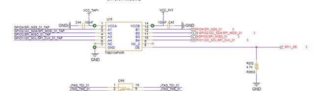

Part Number: TXB0104
Hello!

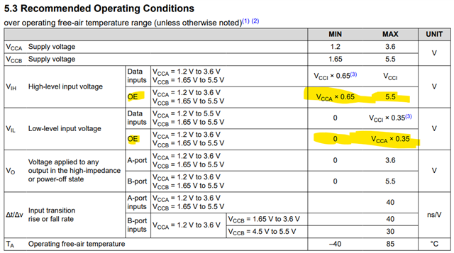

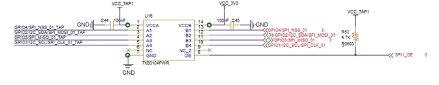

Because OE is powered by VCCA, it is uncertain whether both the pull-down external signal control and the pull-up external signal control are correct in this design?
