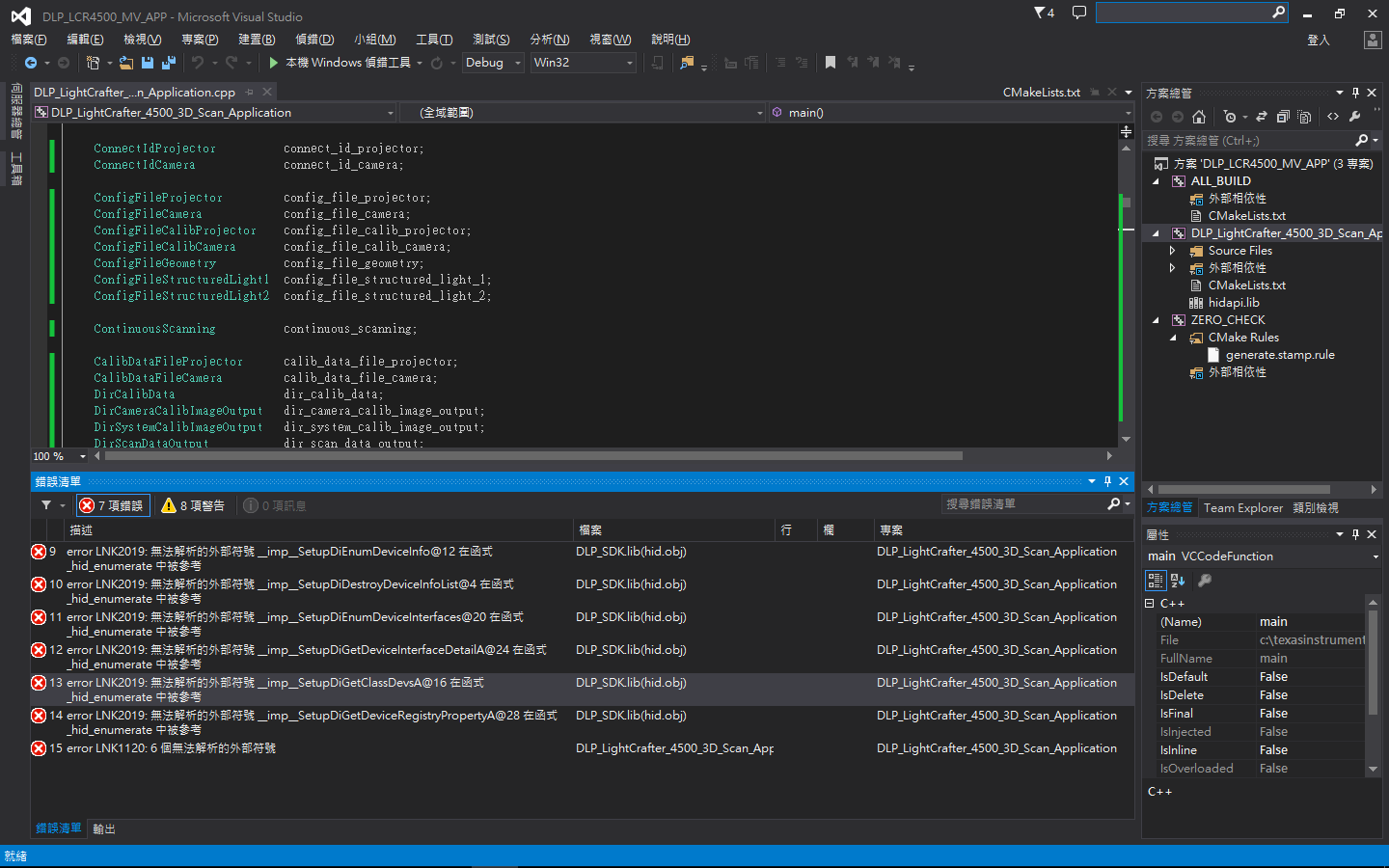

您好,
你們有提供建置好開發包於Visual Studio 2013 環境下使用的的DLP_SDK嗎?
我有參考官網提供的.pdf,
並用CMake建置完成,
但是是在Linux底下的library,
無法匯入Visual Studio使用,

TI 的SDK和USER guide在:
http://www.ti.com/tool/dlp-alc-lightcrafter-sdk
我们的使用环境是(QT):
The following pieces of software are required to build the DLP ALC SDK:
1. CMake v3.1: https://cmake.org/download/
2. Qt v5.3.2 (for the MinGW 4.8 compiler): http://download.qt.io/archive/qt/5.3/5.3.2/
3. OpenCV v2.4.10: https://sourceforge.net/projects/opencvlibrary/files/opencv-win/2.4.10/
4. Doxygen v1.8.11: http://www.stack.nl/~dimitri/doxygen/download.html
5. TI DLP SDK v2.0: http://www.ti.com/tool/DLP-ALC-LIGHTCRAFTER-SDK
Be sure to download the proper file types for your system. These downloads are large and, depending on
your web connection, can take a long time. Throughout this guide we will be using a 32-bit Windows 7
system. The file names and approximate sizes in this case are:
• cmake-3.5.0-win32-x86.msi (15 Mb)
• qt-opensource-windows-x86-mingw482_opengl-5.3.2.exe (737 Mb)
• opencv-2.1.10.exe (367.3 Mb)
• doxygen-1.8.11-setup.exe (24 Mb)
• DLPSDK-2.0-windows-installer.zip (7kB)
请参考embedded Linux:
http://www.ti.com/cn/lit/pdf/tiduc48
