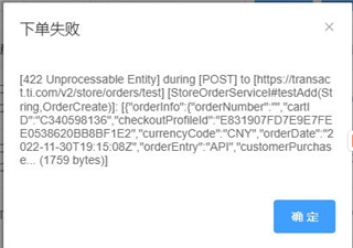

Hi,
第一条的答复有问题,我们通样遇到422和500下单失败的报错,DRV8832QDGQRQ1报422错,换成其他物料就报500的错,烦请支持。
Hi Zhou,
500和422是状态代码,相同的状态代码不一定代表相同的错误信息。

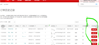

好的,我这边下单报错422,请帮忙看一下,报错信息如下,重点是我们确实没有采购过,但一直报错,是什么情况呢?
"errors":[{"errorCode":"ERR-TICOM-ORDER-API-0004","type":"Validation","section":"Generic","field":null,"reason":"Your company recently purchased TRS3232EQPWRQ1 and must wait 26 days before purchasing again.","message":"Remove the item from your request and resubmit later when the inventory is available to order.","data":[{"customerLineItemNumber":null,"tiPartNumber":"TRS3232EQPWRQ1","quantity":null,"availableQuantity":null,"limit":null,"waitPeriod":"26"}]}]}
Hi,
是我们系统的问题。
我们查询到,是您在测试环境中使用过TRS3232EQPWRQ1这个料号。我们在进行重复下单检测时,没有区分测试环境的数据。
修复完毕后我会通知您。
