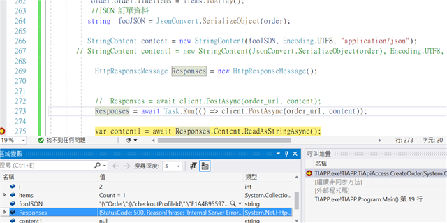

windorm執行API V2 報錯 Status code 500, ReasonPhrase:'Internal Server Error', Version: 1.1, Content: System.Net.Http.StreamContent,
請問我用C#winfrom 執行API V2 下單
透過  HttpResponseMessage 回傳資料卻一直出現Status code 500, ReasonPhrase:'Internal Server Error', Version: 1.1, Content: System.Net.Http.StreamContent,
是甚麼原因?

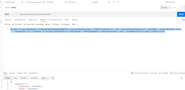

  • 你好,请提供您的API下单Json payload, 谢谢。
  • 你好
    我的JSON如下:
    {"order":{"checkoutProfileId":"F1A4B95597BE241EE0538620BB8B7D47","endCustomerCompanyName":"CYPRESS TECHNOLOGY CO., LTD","customerPurchaseOrderNumber":"2304250001","expediteShipping":false,"OrderNumber":null,"lineItems":[{"customerLineItemNumber":1,"tiPartNumber":"74AHC1G125DBVRG4","customerPartNumber":"test","customReelIndicator":false,"quantity":1}]}}
    我用Postman 測試 可以呈現
  • 另外他回傳訊息如下:
    ERR-TICOM-ORDER-API-GEN-0500
    {    "errors" : [      {        "section" : "Generic",        "errorType" : "Validation",        "errorCode" : "ERR-TICOM-ORDER-API-GEN-0500",        "reason" : "We encountered a technical issue in processing your request.",        "message" : "The API is temporarily unavailable. Please retry, if the issue persists, Please contact TI customer support - https://support.ti.com/csm"      }    ]  }
  • 通过POSTMAN是没有报错的么?
  • hi
    Postman  是可以正常顯示,但我寫成winform 自動執行卻一直報錯
