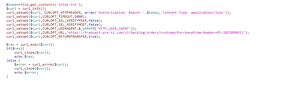

Customer submit order retrieve request in test environment, but got failed. below is data for your reference, thanks!
{ "errors": [ { "errorCode": "TI-API-0422", "type": "Validation", "reason": "Invalid JSON", "message": "JSON payload is in invalid format. Please fix it and resend the request." } ] }
Hi Bella,
I am able to retrieve this PO from Insomia, please try to ask customer unselect "Content-Type" in Header parameters and try again, thanks.
