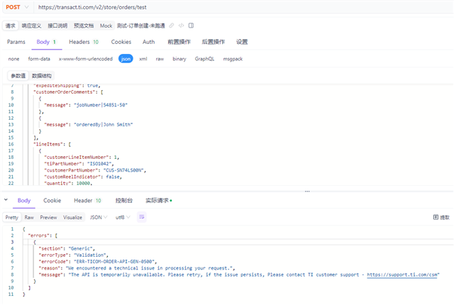

您好,我们取得权限(token)了,现在要做一个订单创建的测试,看了api文档订单创建之前需要调用”库存和价格API“,”库存和价格API“调通了,但是没看到返回信息有创建订单请求体需要的数据,以下是请求体:
"order": {
"checkoutProfileId": "INSERT CHECKOUT PROFILE ID HERE",
"customerPurchaseOrderNumber": "INSERT PO NUMBER HERE",
"endCustomerCompanyName": "INSERT END CUSTOMER NAME HERE",
"expediteShipping": false,
"customerOrderComments": [
"message": "MY TEST ORDER"
"lineItems": [
"customerLineItemNumber": 1,
"tiPartNumber": "NE555DR",
"customerPartNumber": "MY CUSTOMER PARTNUMBER",
"customReelIndicator": false,
"quantity": 1,
"customerItemComments": [
"message": "SOME COMMENT GOES HERE"
"customerLineItemNumber": 2,
"tiPartNumber": "LM358PWR",
"quantity": 1
这三个字段哪里查看:
Hi, Checkout profile ID 和 endCustomerCompanyName 请联系您的销售获取。PO number是自定义的。
您好,
"checkoutProfileId": "已经获取",
"customerPurchaseOrderNumber": "20240815",
"endCustomerCompanyName": "填了公司名称",
发送测试订单请求还是没通过测试
请求帮助,谢谢
