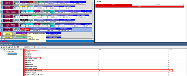

We capture the data of USB, and show error as below photo. Could you please help analyze it and provide some suggestions?

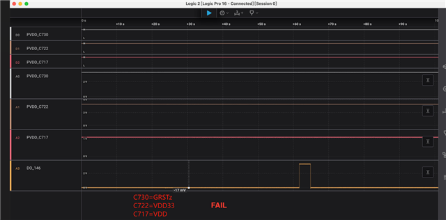

       Can you take waveform for 3.3v/1.1v and GRSTz signal?

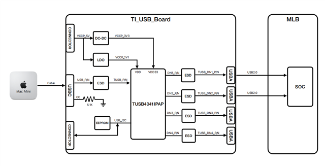

       A block diagram will be easy to understand the setup.

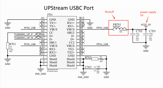

    The issue is happened in our project. and the schematic and block diagram showed as below:
    The mac mini try to install the system into the product through USB2.0.And the restore process have two steps. there exist a reboot between two steps.In the normal case, Mac mini only need to spend 3s to find the device (testing product). But in the abnormal case, Mac mini will spend at least 8s to find the device, and we check the system log of mac miin, find that there exist a reconnection of the hub.But it is strang that  this phenomenon only occurs under the conditions (the first test after power on hub board or restart Mac mini). We suspect that there might be some abnormality in the configuration of TUSB4041?Could you help to review the eeprom setting as the last meassage showed?
    Answer:Capture the waveform of 3V3,1V1,GRSTz signal. And there have not voltage drop or shake.we can refer to the screenshot for detail. The GPIO means the time of fail trigger.
