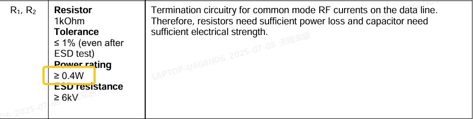

I found the MDI  design requirement in the schematic checklist for DP83TC812S
1.termination resistor is recommended as  1kohm , 0.75W           -> in the open alliance the power rate  is 0.4W ,  I want to know which test requires the 1k  resistor power rate?

  • 1.termination resistor is recommended as  1kohm , 0.75W           -> in the open alliance the power rate  is 0.4W ,  I want to know which test requires the 1k  resistor power rate?
    Let me check internally.

  • OK  thanks for your kindly answer, in open alliance,the 1k resitor power rating is >0.4W .If 0.75W is required, do you know which test require so big  power rate for 1K resistor?
    for DC block capacitor ,if it is 12V system ,50V is enough
  • The TI test boards for 100M parts seem to use 0.5 W most of the time, but I found some with alternate designs that use 0.75 W, possibly for special-purpose tests such as ESD. I will still need some more time for the exact reason because the engineer who designed the boards is out of the office.
    Is there a specific reason why your customer is asking about the resistor wattage? Are the 0.75W resistors causing space issues for the board?
