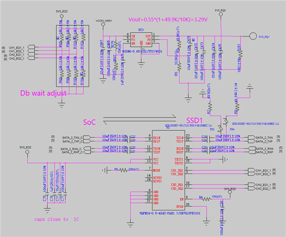

SN75LVPE3101: The SATA signal sent by the SOC, after passing through the relay chip, cannot be transmitted to the SSD, resulting in the SOC being unable to recognize the SSD.
Part Number: SN75LVPE3101
Now, soc is unable to recognize SSD. The serial port printout information is as follows:
1、Our SATA signals are emitted from the motherboard, pass through the adapter board, and reach the hard disk board. The longest length of the TXN/P and TXN/P wiring is approximately 270mm;
2、Now, soc is unable to recognize SSD. The serial port printout information is as follows:

3、We attempted to change C22/C23/C20/C21/C19/C24/C25C26 to 0-ohm resistors, 1nF capacitors, and 220nF capacitors, but we were unable to identify the SSD;
4、Finally, we removed the SN75LVPE3101 driver chip and directly connected the AC-coupled capacitors C22/C23/C20/C21/C19/C24/C25/C26 with wires. Our SOC eventually recognized the SSD.
May I ask, how can the SN75LVPE3101 chip operate normally? As mentioned in the specification, what are the exact durations of Tcfg_su and Tcfg_hd in the power-up sequence shown in Fig. 5-1?

    上面的问题简言之就是:
    1、设备上电后,soc的 SATA信号经过 SN75LVPE3101后,无法识别SSD,从串口打印结果上看,物理层就是断开的。我们尝试过去掉SN75LVPE3101,用导线直连两端电容,是可以识别到SSD的;
    2、EQ增益我们也尝试设置过很多组,但都没用,因为物理层未联通;
    3、规格书中所提到的 上电时序,EN要经过多久才生效,才能让SN75LVPE3101正常工作?大家能否帮忙给出正确的上电时序时间要求?
  • For sata device only, AC cap is 10-12nf, then no FB and 50 ohm termination is needed on TX
    please replace C25/26  with 0ohm  as well on RX2p/RX2n.
  • I followed your instructions and deleted the magnetic beads FB3 and FB4. I also changed the resistance of C25/C26 to 0 ohms. However, there was still no improvement. The SSD could not be recognized.
    我按照您说的 删除了  磁珠FB3、FB4,同时将C25/C26改为了0欧姆电阻,也还是没有效果,仍然无法识别SSD
