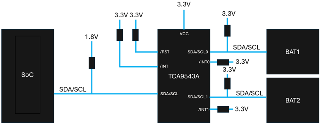

TCA9543A: TCA9543A used in different pull high power domain
Part Number: TCA9543A
Due to SoC's IO support 1.8V only, but 2 BATs are support 3.3V with the same I2C address so that we need adding a TCA9543A between SoC and 2 batteries,
want to confirm if that can be designed as below:
Please help to confirm if these pull high power domain is workable. (1.8V and 3.3V)
Note, we don’t use INT and RST signals.
