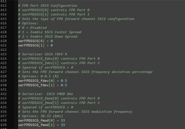

The 98x Script Gen Tool has an option to configure FPD-Link forward channel SSCG. Are you needing to generate a script for a specific configuration? I can generate a script for you if you know the FPD-Link rate (3.375Gbps, 6.75Gbps, etc.).

The question I want to ask is how to configure the spread spectrum of the master device 98390UH983 through the slave device DS90UB688.
I also have another question: For the 688's spread spectrum frequency, is it better to set it to 5% or 2%?
To send I2C transactions from DES to the SER, the I2C_PASS-THROUGH bit (UB688 MainPage 0x4[3]) will need to be set. The DES will forward transactions that matches the I2C address found in the UPSTREAM_ID register (UB688 MainPage 0x6)
It will be the same register writes to the 983 for configuring FPD-Link forward channel SSCG. There are no writes needed to the UB688 for the SSCG function.
