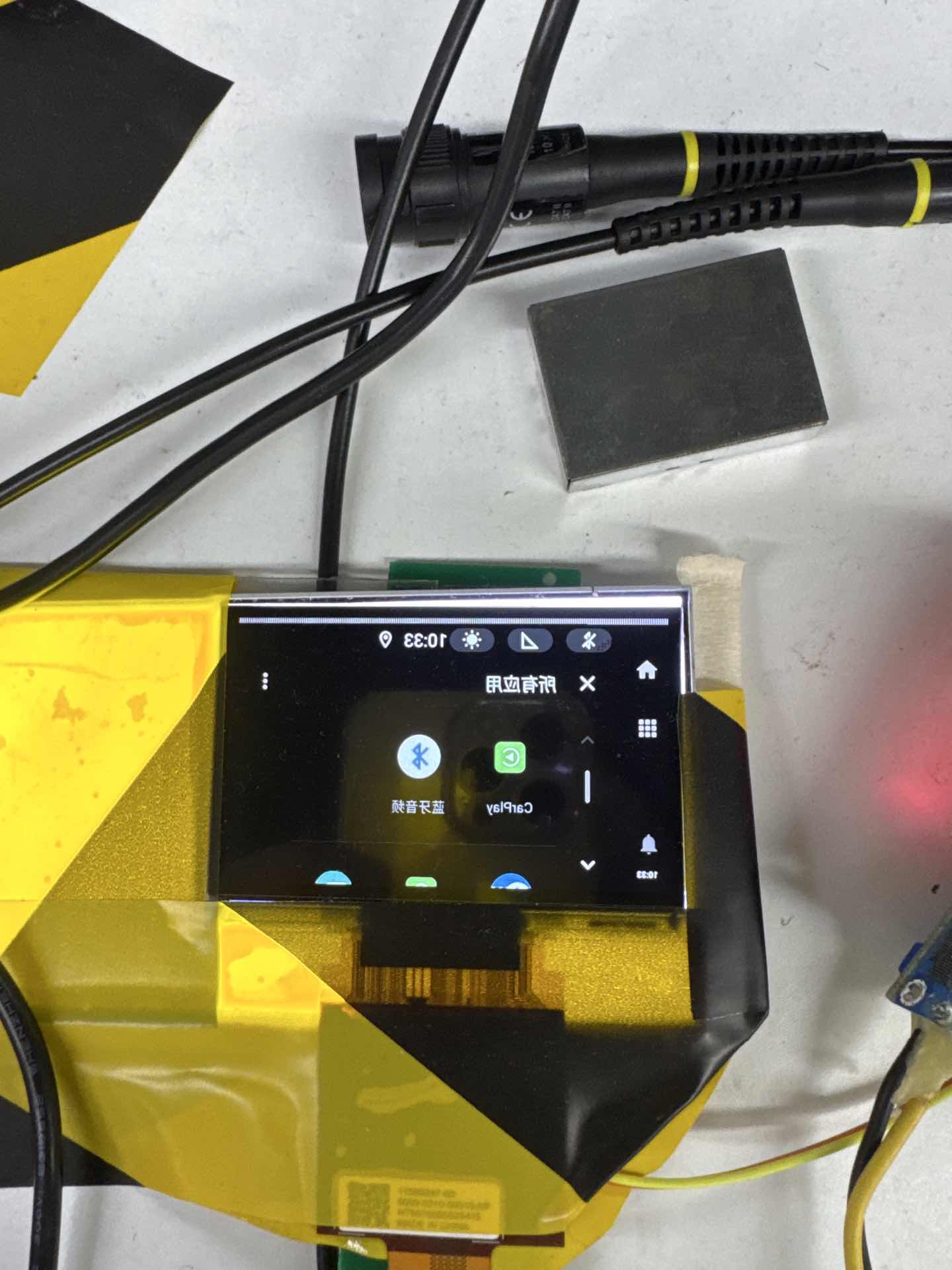

DS90UB941AS-Q1: The image cannot be shifted upward to fully cover the entire screen
Part Number: DS90UB941AS-Q1
Other Parts Discussed in Thread: DS90UB928Q-Q1
We have a project using the ds90ub941as-q1 and ds90ub928q-q1 chips. Despite repeated debugging of screen parameters on the SoC side, the image cannot be shifted upward to fully cover the entire screen (as shown in the attached document). Is there a debugging solution related to the Serializer/Deserializer (SerDes) registers to address this issue?63a2d0b2acba6ad8ec6121f0860a92e.jpg

  • Hi

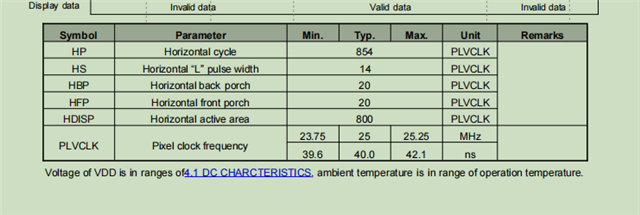

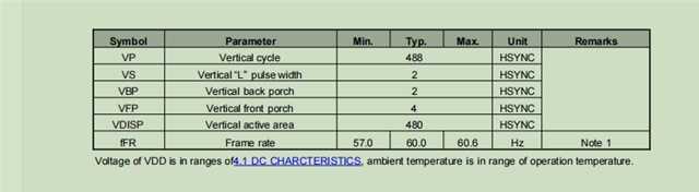

    Thank you for attaching the image of the issue. We will need to first identify if this screen shifting is related to the SERDES or the DSI input. The UB941AS has a PATGEN that we can use to send over a pattern to see if there are still issues on the screen. I will need the video timing information for the display in order to make a script for this.

  •  I will need the video timing information for the display

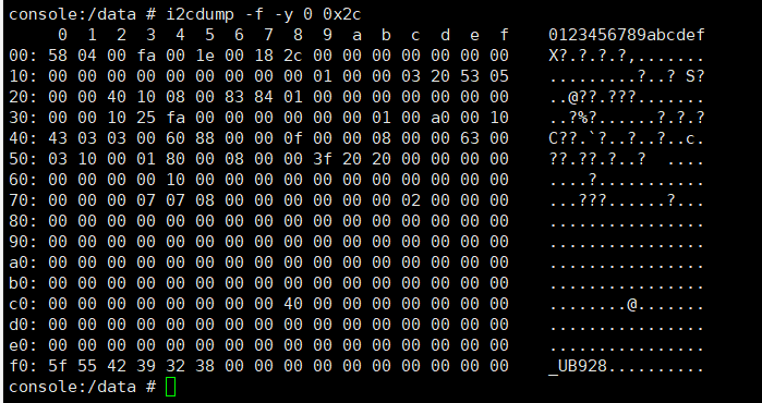

    Using DSI reference clock?
    reply:yes.
    Register dump of the UB941AS:
    Register dump of the UB928AS:
  • 您好
    Thank you for the detailed response. From the register dump, I noted the following
    • Lock is established
    • FPD-Link III Single Port 0 Mode
    • DSI PCLK Frequency = 25MHz
    • DSI frequency is stable
    Is the DSI TX operating in burst mode or non-burst mode?
    There are some missing configurations in the UB941AS. These might not be the root cause of the shifted screen but are needed for stable operation

    See below script for UB941AS PATGEN with internal timings.
    serAddr = 0x18
    board.WriteI2C(serAddr, 0x64, 0x00)    #   Disable PATGEN
    board.WriteI2C(serAddr, 0x66, 0x03)
    board.WriteI2C(serAddr, 0x67, 0x40)    #   PATGEN_CDIV_N
    board.WriteI2C(serAddr, 0x66, 0x04)
    board.WriteI2C(serAddr, 0x67, 0x56)    #	THW_7:0
    board.WriteI2C(serAddr, 0x66, 0x05)
    board.WriteI2C(serAddr, 0x67, 0x83)    #	TVW_3:0
    board.WriteI2C(serAddr, 0x66, 0x06)
    board.WriteI2C(serAddr, 0x67, 0x1E)    #	TVW_11:4
    board.WriteI2C(serAddr, 0x66, 0x07)
    board.WriteI2C(serAddr, 0x67, 0x20)    #	AHW_7:0
    board.WriteI2C(serAddr, 0x66, 0x08)
    board.WriteI2C(serAddr, 0x67, 0x03)    #	AVW_3:0
    board.WriteI2C(serAddr, 0x66, 0x09)
    board.WriteI2C(serAddr, 0x67, 0x1E)    #	AVW_11:4
    board.WriteI2C(serAddr, 0x66, 0x0A)
    board.WriteI2C(serAddr, 0x67, 0x0E)    #	HSW_7:0
    board.WriteI2C(serAddr, 0x66, 0x0B)
    board.WriteI2C(serAddr, 0x67, 0x02)    #	VSW_7:0
    board.WriteI2C(serAddr, 0x66, 0x0C)
    board.WriteI2C(serAddr, 0x67, 0x14)    #	HBP
    board.WriteI2C(serAddr, 0x66, 0x0D)
    board.WriteI2C(serAddr, 0x67, 0x02)    #	VBP
    board.WriteI2C(serAddr, 0x66, 0x0E)
    board.WriteI2C(serAddr, 0x67, 0x03)    #	VS_POL, HS_POL
    board.WriteI2C(serAddr, 0x66, 0x1A)
    board.WriteI2C(serAddr, 0x67, 0x02)    #   PATGEN_CDIV_M
    board.WriteI2C(serAddr, 0x65, 0x04)    #   Internal timing
    board.WriteI2C(serAddr, 0x64, 0x05)	   #   Enable PATGEN with color bars
