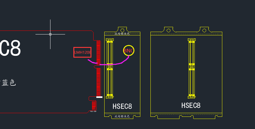

以LMH1208来举例:SDI_OUT1± 和SDI_OUT2± 的单端75欧姆输出,用户手册上说尽量缩短芯片端口到BNC的距离,但是我现在有一个产品,硬件上已经决定了LMH1208到BNC的距离比较长,且中间有经过接插件(金手指,以及SMTEC30G速率接插件),(参考附件)。  请问这种情况我们应该如何处理?更改板材能否达到效果?   以上情况需要支持 12G速率的  2160P50SDI
  • 以及LMH1297和LMH1219 单端75欧姆12GSDI输入。 共有10个BNC ,芯片也不能放在BNC所在的板子上。
  • 您好,我的建议是SDout输出尽可能的靠近BNC接口,因为是从插值损耗,AC 耦合,输出上升沿和下降沿三个方面考虑的,从而来满足SMPTE 标准。您现在实际有没有验证信号的完整性? rise time,fall time,眼图都还理想吗?
    datasheet中有SMPTE 对SDI接口的几点要求:TI recommends placing the LMH1208 as close as possible to the 75-Ω BNC ports to meet SMPTE specifications.
    1. Return Loss: This specification details how closely the port resembles 75-Ω impedance across a specified frequency band. The LMH1208 features a built-in 75-Ω return-loss network on SDI_OUT1 and SDI_OUT2 to minimize parasitics and improve overall signal integrity.
    2. AC Coupling: AC-coupling capacitors are required for transporting uncompressed serial data streams with heavy low-frequency content. The use of 4.7-μF, AC-coupling capacitors is recommended to avoid lowfrequency DC wander.
    3. Rise/Fall Time: Output 75-Ω signals are required to meet certain rise and fall timing depending on the data rate. This improves the eye opening observed for the receiving device. The LMH1208 SDI_OUT1 and SDI_OUT2 cable drivers feature programmable edge rate adjustment to meet SMPTE rise and fall time requirements.
  • 我也是看到手册这个地方的说明
    目前还没有实物,也没法看眼图质量如何.
    之前用过LMH1208/LMH1228,但是1208和BNC很近,新产品中产品条件限制了1208和BNC的距离比较远。  所以想提前咨询一下。
    或者有没有资料 线长不同,眼图等差距对比说明呢。
