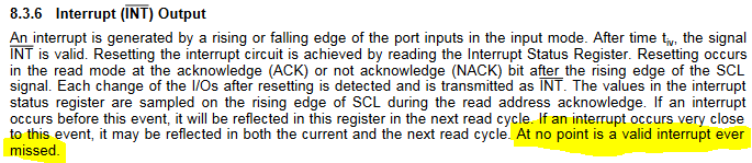

    主要是我在PCA9534数据手册9.2.3 Interrupt Output (INT)看到“Interrupts that occur during the ACK or NACK clock pulse can be lost (or be very short) due to the resetting of the interrupt during this pulse.”:在ACK或NACK脉冲期间发生的中断可能会由于在该脉冲期间中断的重置而丢失
    我看了几个其他I2C I/O扩展器都有这个缺陷,但TCA7408 可以"At no point is a valid interrupt ever missed",但TCA7408 好像已停产
