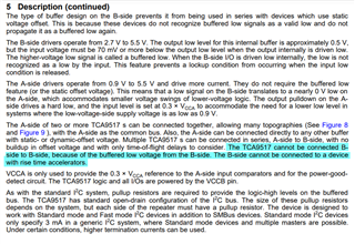

The above picture is Typical Star Application of TCA9517,The Slave Devices connect Master with TCA9517s . My question is that all slave devices connect with one bus(VCCB side) through one TCA9517,is that ok!
Hi Zhicheng,
Generally, communication is unlikely to work properly when the B sides are connected to one another. The device uses a "VOL" level on its B side that is higher than its "VIL" level. This means that it doesn't recognize its own low output level as a logic low. It is also described in detail in the datasheet as shown in the screenshot below

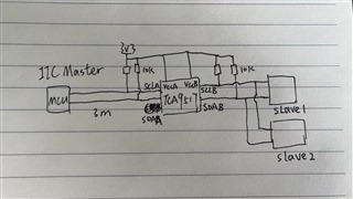

A terminal is connected with 3M wire, and B terminal is connected with two IIC slave devices,Vcca=Vccb=3.3V,Is this ok?
As described in the datasheet “The TCA9517 cannot be connected B-side to B-side”. So we cannot guarantee that's will work normally.
B terminal is connected with two IIC slave devices,A terminal connected master,Only one chip TCA9517
Can you draw an architecture diagram? In this way, I can understand your application more clearly.
As long as you stay within the recommended bus capacitance for the I2C standard you should be fine having multiple slave devices on the A and B side.
