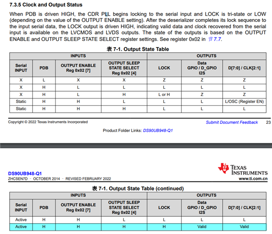

你好,我想请问下948 的0x1c寄存器,bit0位没有lock可能的原因是什么呢?
| De-Serializer CDR, PLL's clock to recovered clock frequency |
| 1: De-Serializer locked to recovered clock 0: De-Serializer not locked In Dual-link mode, this indicates both channels are locked. |

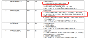

是的,配置 0x65 PGCFG寄存器 0x0C ;0x64 PGCTL 寄存器 0x05
下面文档讲了 pattern generator应用,您可以看下:
