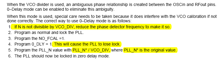

  • Dear Liu,it's very kind of you for answering my questions one by one.I'm very sorry for not informing you that i have already pulled the output up with a resistor of 51ohm in advance. As to what i have done to get the loop on road,i changed the loop filter values asyou told me!Thanks!And now,i found that when i set the the OUTA_MUX and OUTB_MUX as VCO,there is output on RFoutA as well as RFoutB.But once i set them as channel divider mode,there is no output on both of them,and i suppose that is about why i have no output before!And i know that i  forget to set zero_delay!I always use the channel divider mode instead of VCO directly because of the maximum sample frequency of the oscilloscope i'm using is 4G sa/s.When i set the VCO mode,i get the output by using the spectrum analyzer.I'm so sorry to get you so much trouble.Now i'm wondering how can i configure it with 0 delay mode?The datasheet of lmx2581 present the configuration as following:
    I configured it as step 1~6,but unfortunately,the loop wasn't locked.And the light flashed when i configured the LD pin as DLD&Vtune which demonstrate that the pll locked and then lose lock.When i program the PLL_N of R0 at last,the pll stayed unlock.OSCin = 100MHz,R = 5,VCO = 3000MHz,N = 120,VCO_DIV = 6;After programing as normal,I programed as following:
    1st kind of configuration:
    R0 0x50780000
    R5 0x0030AC05
    R0 0x503C0000
    2nd kind of configuration:
    R0 0x50780000
    R5 0x0030AC05
    R0 0x403C0000
    Neither of two kinds of configuration is locked!So,can you tell me how to configuration the 0 delay mode?Thanks for your answer!
  • Hello carter!Noel Fung said that he will answer my question in your post, and you will let me know his feedback.May i know it?Thank you!

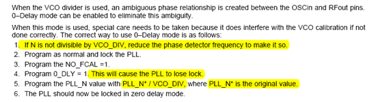

  • I have no problem with zero delay and channel divider. Here is the procedure:
    1. use your original configuration in the first post
    2. change the VCO freq to 3000MHz (N becomes 150)
    3. change channel divider to 6 (output freq becomes 500MHz)
    4. load all register to make it lock (the measured output freq is 500MHz on RFoutA)
    5. program NO_FCAL=1
    6. program ZERO_DELAY=1 (I can see PLL lose lock)
    7. program N=25 (=150/6) (PLL resumes to lock now)
    BTW, just found out that the transformer at the RF output is not correct. You should pick a 2:1
    transformer.
