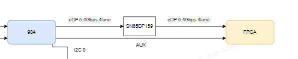

Hi,
Does SN65DP159 supports eDp to eDp?

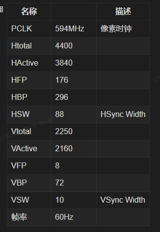

Below is the block diagram of our program:
Thank you for your time and assistance. I look forward to your response.
The DP159 can be used a DP/eDP re-timer, please see this app note, https://www.ti.com/lit/an/slla358/slla358.pdf. But do they need a re-timer or can they use TDP142 re-driver for this design?
