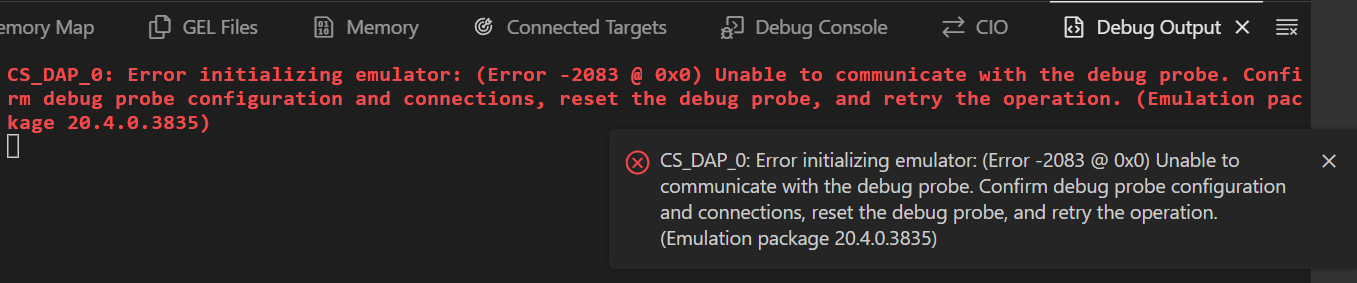

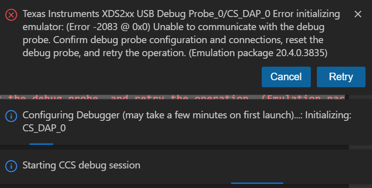

CCS 错误:
Texas Instruments XDS2xx USB Debug Probe_0/CS_DAP_0 Error initializing emulator:
(Error -2083 @ 0x0) Unable to communicate with the debug probe.
Confirm debug probe configuration and connections, reset the debug probe,
and retry the operation. (Emulation package 20.4.0.3835)

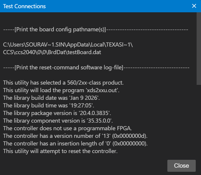

Test Connection from .ccxml Advance settings 提供:
-----[Print the board config pathname(s)]------------------------------------
C:\Users\SOURAV~1.SIN\AppData\Local\TEXASI~1\
CCS\ccs2040\0\0\BrdDat\testBoard.dat
-----[Print the reset-command software log-file]-----------------------------
This utility has selected a 560/2xx-class product.
This utility will load the program 'xds2xxu.out'.
E_RPCENV_IO_ERROR(-6) No connection: DTC_IO_Open::dtc_io
Failed to open i/o connection (xds2xxu:0)
An error occurred while soft opening the controller.
-----[An error has occurred and this utility has aborted]--------------------
This error is generated by TI's USCIF driver or utilities.
The value is '-250' (0xffffff06).
The title is 'SC_ERR_ECOM_EMUNAME'.
The explanation is:
An attempt to access the debug probe via USCIF ECOM has failed.

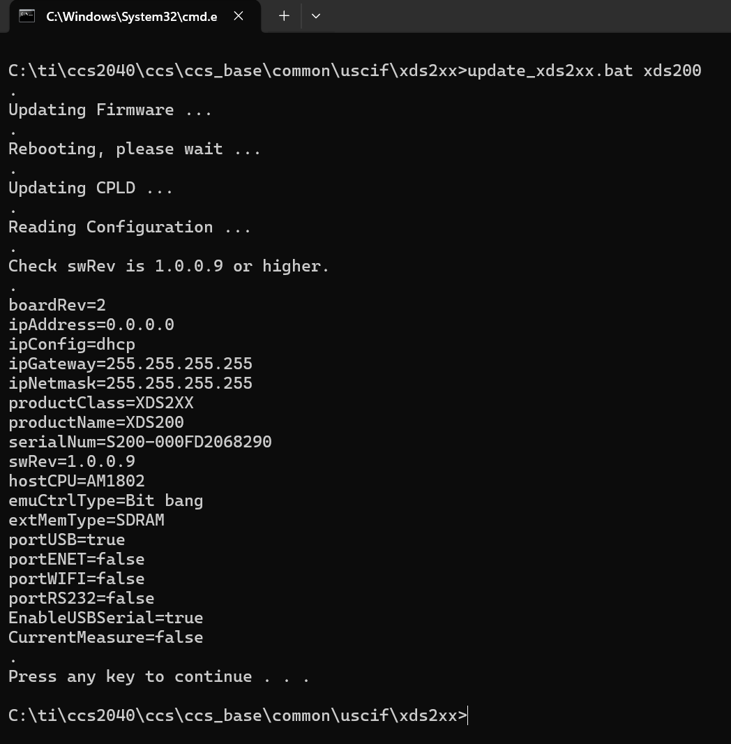

我还尝试了使用以下器件恢复/更新 XDS200 固件:
C:\ti\ccs2040\ccs\ccs_base\common\uscif\xds2xx>update_xds2xx.bat xds200
输出:
Updating Firmware ...
Rebooting, please wait ...
Updating CPLD ...
Reading Configuration ...
boardRev=2
ipAddress=0.0.0.0
ipConfig=dhcp
ipGateway=255.255.255.255
ipNetmask=255.255.255.255
productClass=XDS2XX
productName=XDS200
serialNum=S200-000FD2068290
swRev=1.0.0.9
hostCPU=AM1802
emuCtrlType=Bit bang
extMemType=SDRAM
portUSB=true
portENET=false
portWIFI=false
portRS232=false
EnableUSBSerial=true
CurrentMeasure=false
因此、固件更新成功、PC 检测到 XDS200、但 CCS 仍然无法连接。

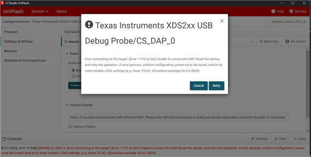

    我们还使用 UniFlash GUI 进行检查、并且 XDS200 未在该处连接。

    以下是来自测试连接的日志:
    ----- 【打印线路板配置路径名】------------------------------------
    C:\Users\Sarita~1.Jan\AppData\Local\TEXASI~1\ccs\ccs2040\0\BRDDAT\testBoard.dat
    ----- 【打印重置命令软件日志文件】------------------------------------
    此实用程序选择了 560/2xx 级产品。
    此实用程序将加载程序“xds2xxu.out“。
    E_RPCENV_IO_ERROR(–6)
    无连接:
    DTC_IO_Open:DTC_IO 无法打开 I/O 连接 (xds2xxu:0)
    软打开控制器时出错。
    ----- 【发生错误,此实用程序已中止】------------------------
    此错误由 TI 的 USCIF 驱动程序或实用程序生成。
    值为“–250“(0xffffff06)。
    标题为“C_ERR_ECOM_EMLAME“。
    解释如下:
    “尝试通过 USCIF ECOM 访问调试探针失败。“
    您能否提供此问题的确切解决方案或恢复过程?
