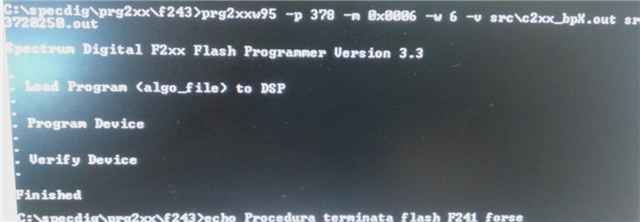

我需要 在现场返回的一些旧电路板上执行 TMS320F241片上闪存验证。 我使用的是:
-具有 TMS320F241的主板
- XDS510PP+仿真器
- Windows XP 下的 prg2xxw95.exe 实用程序(我没有 Code Composer Studio)
我能够 使用以下命令对片上 TMS320F241闪存进行编程和验证:
prg2xxw95 -p 378 -m 0x0006 -w 6 -v src \c2xx_BPx.out src \63720250.out
我无法只验证片上闪存。 问题:哪种方法是仅验证片上闪存而无需之前对其进行编程? 我尝试了一些组合但没有成功。
感谢您的支持!
Andrea

    Andrea、
    下面是我在 prg2xxx 编程软件附带的自述文件中找到的内容、该实用程序没有"verify only (仅验证)"选项。
    PRG2XX -[options] c2xxprog.out flashcode.out
    Option Description.
    -h Help, Lists the options.
    -n Device Name Identifies the processor to program if multiple devices are
    connected to the scan-chain. For more details on this option
    see Subsection 3.2, Describing the Target System to the Loader.
    Optional, default=c200.
    - p port address Specifies IO address for XDS510 card in the PC. Optional,
    default = 240.
    - w time-out Specifies time-out limit (1-6) for the host while programming.
    Necessary to match fast and slow PCs. Optional, default = 1.
    - i I/O register I/O address to be initialized before program loading. Used
    to initialize the SARAM mapping in the PMST register at
    0xFFE4h.Optional, default 0xFFE4.
    - m I/O value Value to be written in the I/O address specified by the -i
    option. For flash programming the value 0x0006 should be
    written in the PMST register. To initialize PMST register at
    0xFFE4, just use -m 0x0006; -i option is not required.
    Optional, default = no-load.
    - o No flashcode COFF file for programming
    - t ST1 value Initialize ST1 register. Optional, default 0x17FC.
    - e Run PRG_erase function before executing PRG_prog function.
    Optional, default = not selected.
    - v Run PRG_verify function after executing PRG_prog function.
    Optional, not used with rev 2.0.
    default If neither -e or -v options are specified, the loader will run
    PRG_init first followed by PRG_prog and PRG_stop. These
    functions are defined in the c2xxprog.out COFF files.
