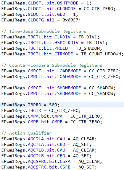

我使用 ePWM 全局加载功能。 下图显示了我的配置。
每次执行控制时、我都会将 PWM1 和 PWM2 的 PRD 值更改 10 个计数。 我设置 CMPA = PRD - 7 和 CMPB = 7、并将 PWM1 配置为仅在 CTR = PRD 时进入中断、其中 I set。 EPwm1Regs.GLDCTL2.bit.OSHTLD = 1但是、在测量 PWM 输出 B 时、我发现 PWM2 经常产生不正确的输出。

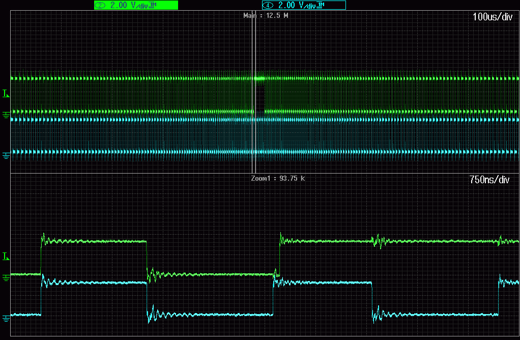

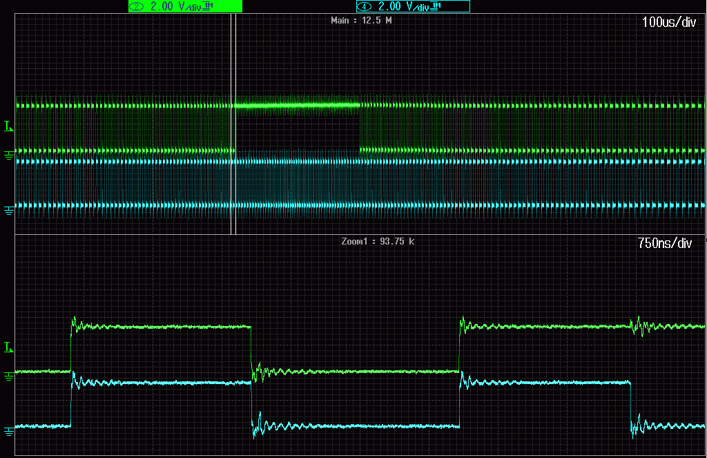

“可能会发生两种类型的错误情况。
蓝色为 PWM1B、绿色为 PWM2B。
在第一个图中、PWM2B 晚于 PWM1B 变为高电平。 发现 PWM2 未加载新的 PRD 和 CMPA/B 值。
在第二个图中、虽然 PWM2B 和 PWM1B 同时变为高电平、但 PWM2B 之后不会变为低电平。 PWM2 似乎更新了 CMPA/B、但没有更新 PRD。
只要 PRD 的变化大于 CMPB 值、这种情况就会随机发生。

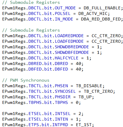

    感谢您的答复。 下面是用于我的配置的代码。
    EPwm1Regs.GLDCTL.bit.OSHTMODE = 1;
    EPwm1Regs.GLDCTL.bit.GLDMODE = 0;
    EPwm1Regs.GLDCTL.bit.gLD = 1;
    EPwm1Regs.GLDCFG.all = 0x00E7;
    EPwm1Regs.TBCTL.BIT.CLKDIV = 0;
    EPwm1Regs.TBCTL.BIT.HSPCLKDIV = 0;
    EPwm1Regs.TBCTL.BIT.PRDLD = 0;
    EPwm1Regs.TBCTL.BIT.CTRMODE = 2;
    EPwm1Regs.CMPCTL.bit.LOADBMODE = 0;
    EPwm1Regs.CMPCTL.bit.LOADAMODE = 0;
    EPwm1Regs.CMPCTL.bit.SHDWBMODE = 0;
    EPwm1Regs.CMPCTL.bit.SHDWAMODE = 0;
    EPwm1Regs.TBPRD = 500;
    EPwm1Regs.TBCTR = 0;
    EPwm1Regs.CMPA.bit.CMPA = 0;
    EPwm1Regs.CMPB.bit.CMPB = 0;
    EPwm1Regs.AQCTLA.bit.CAU = 1;
    EPwm1Regs.AQCTLA.bit.CBD = 2;
    EPwm1Regs.AQCTLB.bit.CAU = 1;
    EPwm1Regs.AQCTLB.bit.CBD = 2;
    EPwm1Regs.AQCSFRC.bit.CSFA = 1;
    EPwm1Regs.AQCSFRC.bit.CSFB = 2;
    EPwm1Regs.DBCTL.BIT.OUT_MODE = 3;
    EPwm1Regs.DBCTL.BIT.POLSEL = 2;
    EPwm1Regs.DBCTL.bit.IN_MODE = 2;
    EPwm1Regs.DBCTL.BIT.LOADREDMODE = 0;
    EPwm1Regs.DBCTL.BIT.LOADFEDMODE = 0;
    EPwm1Regs.DBCTL.BIT.SHDWDBREDMODE = 1;
    EPwm1Regs.DBCTL.BIT.SHDWDBFEDMODE = 1;
    EPwm1Regs.DBCTL.BIT.HALFCYCLE = 1;
    EPwm1Regs.DBRED.bit.DBRED = 40;
    EPwm1Regs.DBFED.bit.DBFED = 40;
    EPwm1Regs.TBCTL.BIT.PHSEN = 0;
    EPwm1Regs.TBCTL.bit.SYNCOSEL = 1;
    EPwm1Regs.TBCTL.bit.PHSDIR = 1;
    EPwm1Regs.TBPHS.bit.TBPHS = 0;
    EPwm1Regs.ETSEL.bit.INTSEL = 2;
    EPwm1Regs.ETSEL.bit.intEn = 1;
    EPwm1Regs.ETPS.bit.INTPRD = 1;

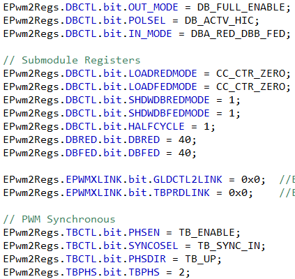

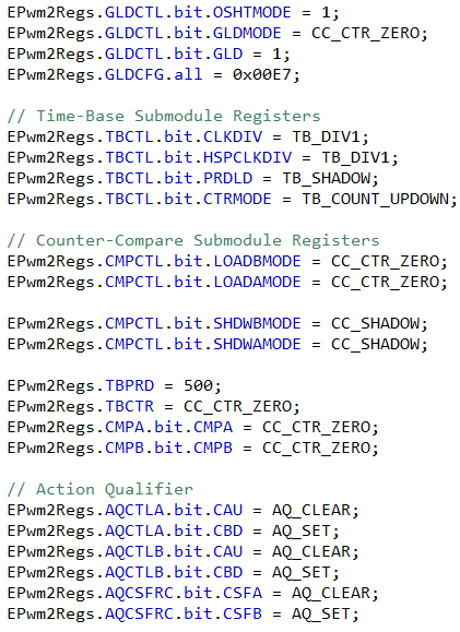

    EPwm2Regs.GLDCTL.bit.OSHTMODE = 1;
    EPwm2Regs.GLDCTL.bit.GLDMODE = 0;
    EPwm2Regs.GLDCTL.bit.gLD = 1;
    EPwm2Regs.GLDCFG.all = 0x00E7;
    EPwm2Regs.TBCTL.BIT.CLKDIV = 0;
    EPwm2Regs.TBCTL.BIT.HSPCLKDIV = 0;
    EPwm2Regs.TBCTL.bit.PRDLD = 0;
    EPwm2Regs.TBCTL.BIT.CTRMODE = 2;
    EPwm2Regs.CMPCTL.bit.LOADBMODE = 0;
    EPwm2Regs.CMPCTL.bit.LOADAMODE = 0;
    EPwm2Regs.CMPCTL.bit.SHDWBMODE = 0;
    EPwm2Regs.CMPCTL.bit.SHDWAMODE = 0;
    EPwm2Regs.TBPRD = 500;
    EPwm2Regs.TBCTR = 0;
    EPwm2Regs.CMPA.bit.CMPA = 0;
    EPwm2Regs.CMPB.bit.CMPB = 0;
    EPwm2Regs.AQCTLA.bit.CAU = 1;
    EPwm2Regs.AQCTLA.bit.CBD = 2;
    EPwm2Regs.AQCTLB.bit.CAU = 1;
    EPwm2Regs.AQCTLB.bit.CBD = 2;
    EPwm2Regs.AQCSFRC.bit.CSFA = 1;
    EPwm2Regs.AQCSFRC.bit.CSFB = 2;
    EPwm2Regs.DBCTL.bit.OUT_MODE = 3;
    EPwm2Regs.DBCTL.BIT.POLSEL = 2;
    EPwm2Regs.DBCTL.bit.IN_MODE = 2;
    EPwm2Regs.DBCTL.BIT.LOADREDMODE = 0;
    EPwm2Regs.DBCTL.BIT.LOADFEDMODE = 0;
    EPwm2Regs.DBCTL.BIT.SHDWDBREDMODE = 1;
    EPwm2Regs.DBCTL.BIT.SHDWDBFEDMODE = 1;
    EPwm2Regs.DBCTL.BIT.HALFCYCLE = 1;
    EPwm2Regs.DBRED.bit.DBRED = 40;
    EPwm2Regs.DBFED.bit.DBFED = 40;
    EPwm2Regs.EPWMXLINK.bit.gLDCTL2LINK = 0x0;
    EPwm2Regs.EPWMXLINK.bit.TBPRDLINK = 0x0;
    EPwm2Regs.TBCTL.BIT.PHSEN = 1;
    EPwm2Regs.TBCTL.bit.SYNCOSEL = 0;
    EPwm2Regs.TBCTL.bit.PHSDIR = 1;
    EPwm2Regs.TBPHS.bit.TBPHS = 2;
