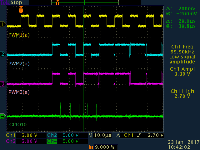

我正在使用 TMS320F28377S 并配置 全局 PWM 负载功能。
我对该函数有一些疑问。
1:
我使用 GLDCNT 更新寄存器(CMPA、CMPB 等) 正时调整。
我通过类似的方式检查了 ePWM1处的 GLDCNT 值
(GCNT1 = EPwm2Regs.GLDCTL.bit.GLDCNT;)
然后、我注意到 GLDCNT 值在 A 点为0、在 B 点为1 (请参阅以下代码)
EALLOW;
EPwm2Regs.GLDCTL.ALL = 0x0183U;
EPwm2Regs.GLDCFG.ALL = 0x0002U;
EDIS;
 EPwm2Regs.TBCTL.ALL      = 0x8003U;
 EPwm2Regs.TBPRD                = 999;
(A 点)
EPwm2Regs.TBCTL.bit.CTRMODE    = 0U;
CpuSysRegs.PCLKCR0.bit.TBCLKSYNC = 0x1U;
(B 点)
因此、我将初始 GLDCNT 值解释为1、因为 当 TBCLKSYNC=1U 时、该值会变为0至1;
这种解释是否正确?
2:
配置为 以下时
EALLOW;
EPwm3Regs.GLDCTL.ALL = 0x0181U;//当 TBCTR = 0U 且 GLDPRD = 3U 时加载寄存器*/
EPwm3Regs.GLDCFG.ALL = 0x0002U;
EDIS;
EPwm3Regs.TBPRD                = 999;
EPwm3Regs.TBCTL.bit.CTRMODE    = 0U;
GLDCNT 值会发生类似的变化
0→1 (当 TBCLK = 1U 时)→2 (10us 后)
TBCTR 会发生类似的变化
0→0 (当 TBCLK = 1U 时,TBCTR 开始递增计数(C 点))→999 (达到 TBPRD 值)→0 (分频器10us,GLDCNT 值将1更改为2)
这是否意味着第一个 TBCTR = 0U (C 点)不被视为 TBCTR = 事件?

  GpioCtrlRegs.GPAMUX1.bit.GPIO5=0U  ;
  GpioCtrlRegs.GPAGMUX1.bit.GPIO5    = 0U;
  GpioCtrlRegs.GPADIR.bit.GPIO5  = 0U;
  GpioCtrlRegs.GPAMUX1.bit.GPIO10  = 0U;
  GpioCtrlRegs.GPAGMUX1.bit.GPIO10    = 0U;
  GpioCtrlRegs.GPADIR.bit.GPIO10  = 0U;
  GpioCtrlRegs.GPAMUX1.bit.GPIO11  = 0U;
  GpioCtrlRegs.GPAGMUX1.bit.GPIO11    = 0U;
  GpioCtrlRegs.GPADIR.bit.GPIO11  = 0U;
  EPwm1Regs.GLDCTL.ALL = 0x0183U;
  EPwm4Regs.GLDCTL.ALL = 0x0187U;
  EPwm5Regs.GLDCTL.ALL = 0x0187U;
  EPwm6Regs.GLDCTL.ALL = 0x0187U;
  EPwm1Regs.GLDCFG.ALL = 0x0000U;
  EPwm4Regs.GLDCFG.ALL = 0x0004U;
  EPwm5Regs.GLDCFG.ALL = 0x0002U;
  EPwm6Regs.GLDCFG.ALL = 0x0002U;
  EDIS;
  EPwm1Regs.TBCTL.ALL       = 0x8003U;
  EPwm1Regs.PCCTL.ALL       = 0x0U;
  EPwm1Regs.TBPRD                =(uint32)(100000 /(CarrierFrequency))-1;
  EPwm2Regs.PCCTL.ALL       = 0x0U;
  EPwm2Regs.TBPRD                =(uint32)(100000 /(CarrierFrequency))-1;
  EPwm3Regs.TBCTL.ALL       = 0x8003U;
  EPwm3Regs.PCCTL.ALL       = 0x0U;
  EPwm3Regs.TBPRD                =(uint32)(100000 /(CarrierFrequency))-1;
  EPwm4Regs.TBCTL.ALL       = 0x8003U;
  EPwm4Regs.PCCTL.ALL       = 0x0U;
  EPwm4Regs.TBPRD                =(uint32)(100000 /(CarrierFrequency))-1;
  EPwm5Regs.TBCTL.ALL       = 0x8003U;
  EPwm5Regs.PCCTL.ALL       = 0x0U;
  EPwm5Regs.TBPRD                =(uint32)(100000 /(CarrierFrequency))-1;
  EPwm6Regs.TBCTL.ALL       = 0x8003U;
  EPwm6Regs.PCCTL.ALL       = 0x0U;
  EPwm6Regs.TBPRD                =(uint32)(100000 /(CarrierFrequency))-1;
  EPwm1Regs.AQCTLA.ALL     = 0x0012U;
  EPwm2Regs.AQCTLA.ALL     = 0x0012U;
  EPwm3Regs.AQCTLA.ALL     = 0x0012U;
  EPwm4Regs.AQCTLA.ALL     = 0x0012U;
  EPwm5Regs.AQCTLA.ALL     = 0x0012U;
  EPwm6Regs.AQCTLA.ALL     = 0x0012U;
  EPwm1Regs.AQSFRC.ALL      = 0U;
  EPwm1Regs.AQCSFRC.ALL      = 0U;
  EPwm2Regs.AQSFRC.ALL      = 0U;
  EPwm2Regs.AQCSFRC.ALL      = 0U;
  EPwm3Regs.AQSFRC.ALL      = 0U;
  EPwm3Regs.AQCSFRC.ALL      = 0U;
  EPwm4Regs.AQSFRC.ALL      = 0U;
  EPwm4Regs.AQCSFRC.ALL      = 0U;
  EPwm5Regs.AQSFRC.ALL      = 0U;
  EPwm5Regs.AQCSFRC.ALL      = 0U;
  EPwm6Regs.AQSFRC.ALL      = 0U;
  EPwm6Regs.AQCSFRC.ALL      = 0U;
  EPwm1Regs.TBCTL.bit.SYNCOSEL    = 2U;
  EPwm1Regs.CMPA.bit.CMPA        =(uint32)(50000 /(CarrierFrequency))- 1UL;
  EPwm1Regs.CMPB.bit.CMPB      = 1UL;
  EPwm1Regs.CMPC                             = 750U;
  EPwm1Regs.CMPD                             =(uint32)(50000 /(CarrierFrequency))- 1UL;
  EPwm1Regs.CMPCTL.bit.SHDWAMODE    = 0U;   /* CMPAShadow        */
  EPwm1Regs.CMPCTL.bit.SHDWBMODE    = 0U;   /* CMPBShadow        *
  EPwm1Regs.CMPCTL2.bit.SHDWCMODE    = 0U;   /* CMPCShadow        */
  EPwm1Regs.CMPCTL2.bit.SHDWDMODE    = 0U;   /* CMPDShadow        */
  EPwm1Regs.TBCTL.bit.PRDLD       = 0U;   // TBPRDShadow             *
  EPwm1Regs.DBCTL.bit.SHDWDBFEDMODE   = 1U;   /* DBFEDShadow                            */
  EPwm1Regs.DBCTL.bit.SHDWDBREDMODE   = 1U;   /* DBREDShadow                             */
  EPwm1Regs.DBCTL.bit.HALFCYCLE      = 1U;
  EPwm1Regs.DBCTL.bit.IN_MODE     = 0U;
  EPwm1Regs.DBCTL.bit.OUT_MODE    = 3U;
  EPwm1Regs.DBCTL.bit.POLSEL     = 2U;
  EPwm1Regs.DBCTL.bit.DEDB_MODE    = 0U;
  EPwm1Regs.DBCTL.bit.OUTSWAP     = 0U;
  EPwm1Regs.TBCTL.bit.PHSEN     = 0U;
  EPwm1Regs.TBCTL.bit.PHSDIR     = 1U;
  EPwm2Regs.TBCTL.bit.SYNCOSEL    = 0U;
  EPwm2Regs.CMPA.bit.CMPA        =(uint32)(50000 /(CarrierFrequency))- 1UL;
  EPwm2Regs.CMPB.bit.CMPB      =(uint32)(50000 /(CarrierFrequency))- 1UL;
  EPwm2Regs.CMPC                             =(uint32)(75000 /(CarrierFrequency))+ 10UL;
  EPwm2Regs.CMPD                             =(uint32)(30000 /(CarrierFrequency))- 1UL;
  EPwm2Regs.TBPHS.bit.TBPHS     =(uint32)(50000 /(CarrierFrequency))- 1UL;
  EPwm2Regs.CMPCTL.bit.SHDWAMODE    = 0U;   /* CMPAShadow        */
  EPwm2Regs.CMPCTL.bit.SHDWBMODE    = 0U;   /* CMPBShadow        *
  EPwm2Regs.CMPCTL2.bit.SHDWCMODE    = 0U;   /* CMPCShadow        */
  EPwm2Regs.CMPCTL2.bit.SHDWDMODE    = 0U;   /* CMPDShadow        */
  EPwm2Regs.TBCTL.bit.PRDLD       = 0U;   // TBPRDShadow             *
  EPwm2Regs.DBCTL.bit.SHDWDBFEDMODE   = 1U;   /* DBFEDShadow                          */
  EPwm2Regs.DBCTL.bit.SHDWDBREDMODE   = 1U;   /* DBREDShadow                            */
  EPwm2Regs.DBCTL.bit.HALFCYCLE      = 1U;
  EPwm2Regs.DBCTL.bit.IN_MODE     = 0U;
  EPwm2Regs.DBCTL.bit.OUT_MODE    = 3U;
  EPwm2Regs.DBCTL.bit.POLSEL     = 2U;
  EPwm2Regs.DBCTL.bit.DEDB_MODE    = 0U;
  EPwm2Regs.DBCTL.bit.OUTSWAP     = 0U;
  EPwm2Regs.TBCTL.bit.PHSEN     = 0U;
  EPwm2Regs.TBCTL.bit.PHSDIR     = 1U;
  EPwm3Regs.TBCTL.bit.SYNCOSEL    = 0U;
  EPwm3Regs.TBPHS.bit.TBPHS     = 0U;
  EPwm3Regs.CMPA.bit.CMPA        =(uint32)(50000 /(CarrierFrequency))- 1UL;
  EPwm3Regs.CMPB.bit.CMPB      =(uint32)(50000 /(CarrierFrequency))- 1UL;
  EPwm3Regs.CMPC                             = 1UL;
  EPwm3Regs.CMPD                             =(uint32)(30000 /(CarrierFrequency))- 1UL;
  EPwm3Regs.CMPCTL.bit.SHDWAMODE    = 0U;   /* CMPAShadow        */
  EPwm3Regs.CMPCTL.bit.SHDWBMODE    = 0U;   /* CMPBShadow        *
  EPwm3Regs.CMPCTL2.bit.SHDWCMODE    = 0U;   /* CMPCShadow        */
  EPwm3Regs.CMPCTL2.bit.SHDWDMODE    = 0U;   /* CMPDShadow        */
  EPwm3Regs.TBCTL.bit.PRDLD       = 0U;   // TBPRDShadow             *
  EPwm3Regs.DBCTL.bit.SHDWDBFEDMODE   = 1U;   /* DBFEDShadow                             */
  EPwm3Regs.DBCTL.bit.SHDWDBREDMODE   = 1U;   /* DBREDShadow                             */
  EPwm3Regs.DBCTL.bit.HALFCYCLE      = 1U;
  EPwm3Regs.DBCTL.bit.IN_MODE     = 0U;
  EPwm3Regs.DBCTL.bit.OUT_MODE    = 3U;
  EPwm3Regs.DBCTL.bit.POLSEL     = 2U;
  EPwm3Regs.DBCTL.bit.DEDB_MODE    = 0U;
  EPwm3Regs.DBCTL.bit.OUTSWAP     = 0U;
  EPwm3Regs.TBCTL.bit.PHSEN     = 0U;
  EPwm3Regs.TBCTL.bit.PHSDIR     = 1U;
  EPwm4Regs.TBCTL.bit.SYNCOSEL    = 2U;
  EPwm4Regs.TBPHS.bit.TBPHS     =偏移;
  EPwm4Regs.CMPA.bit.CMPA        =(uint32)(50000 /(CarrierFrequency))- 1UL;
  EPwm4Regs.CMPB.bit.CMPB      =(uint32)(50000 /(CarrierFrequency))- 1UL;
  EPwm4Regs.CMPC                             = 1U;
  EPwm4Regs.CMPD                             =(uint32)(50000 /(CarrierFrequency))- 1UL;
  EPwm4Regs.CMPCTL.bit.SHDWAMODE    = 0U;   /* CMPAShadow        */
  EPwm4Regs.CMPCTL.bit.SHDWBMODE    = 0U;   /* CMPBShadow        *
  EPwm4Regs.CMPCTL2.bit.SHDWCMODE    = 0U;   /* CMPCShadow        */
  EPwm4Regs.CMPCTL2.bit.SHDWDMODE    = 0U;   /* CMPDShadow        */
  EPwm4Regs.TBCTL.bit.PRDLD       = 0U;   // TBPRDShadow             *
  EPwm4Regs.DBCTL.bit.SHDWDBFEDMODE   = 1U;   /* DBFEDShadow                             */
  EPwm4Regs.DBCTL.bit.SHDWDBREDMODE   = 1U;   /* DBREDShadow                             */
  EPwm4Regs.DBCTL.bit.HALFCYCLE      = 1U;
  EPwm4Regs.DBCTL.bit.IN_MODE     = 0U;
  EPwm4Regs.DBCTL.bit.OUT_MODE    = 3U;
  EPwm4Regs.DBCTL.bit.POLSEL     = 2U;
  EPwm4Regs.DBCTL.bit.DEDB_MODE    = 0U;
  EPwm4Regs.DBCTL.bit.OUTSWAP     = 0U;
  EPwm4Regs.TBCTL.bit.PHSEN     = 0U;
  EPwm4Regs.TBCTL.bit.PHSDIR     = 1U;
  EPwm5Regs.TBCTL.bit.SYNCOSEL    = 2U;
  EPwm5Regs.TBPHS.bit.TBPHS     = 0U;
  EPwm5Regs.CMPA.bit.CMPA        =(uint32)(50000 /(CarrierFrequency))- 1UL;
  EPwm5Regs.CMPB.bit.CMPB      =(uint32)(50000 /(CarrierFrequency))- 1UL;
  EPwm5Regs.CMPC                             = 1U;
  EPwm5Regs.CMPD                             =(uint32)(50000 /(CarrierFrequency))- 1UL;
  EPwm5Regs.CMPCTL.bit.SHDWAMODE    = 0U;   /* CMPAShadow        *
  EPwm5Regs.CMPCTL.bit.SHDWBMODE    = 0U;   /* CMPBShadow        *
  EPwm5Regs.CMPCTL2.bit.SHDWCMODE    = 0U;   /* CMPCShadow        */
  EPwm5Regs.CMPCTL2.bit.SHDWDMODE    = 0U;   /* CMPDShadow        */
  EPwm5Regs.TBCTL.bit.PRDLD       = 0U;   // TBPRDShadow             *
  EPwm5Regs.DBCTL.bit.SHDWDBFEDMODE   = 1U;   /* DBFEDShadow                             */
  EPwm5Regs.DBCTL.bit.SHDWDBREDMODE   = 1U;   /* DBREDShadow                             */
  EPwm5Regs.DBCTL.bit.HALFCYCLE      = 1U;
  EPwm5Regs.DBCTL.bit.IN_MODE     = 0U;
  EPwm5Regs.DBCTL.bit.OUT_MODE    = 3U;
  EPwm5Regs.DBCTL.bit.POLSEL     = 2U;
  EPwm5Regs.DBCTL.bit.DEDB_MODE    = 0U;
  EPwm5Regs.DBCTL.bit.OUTSWAP     = 0U;
  EPwm5Regs.TBCTL.bit.PHSEN     = 0U;
  EPwm5Regs.TBCTL.bit.PHSDIR     = 1U;
  EPwm6Regs.TBCTL.bit.SYNCOSEL    = 3U;
  EPwm6Regs.TBCTL2.bit.SYNCOSELX    = 0U;
  EPwm6Regs.TBPHS.bit.TBPHS     = 0U;
  EPwm6Regs.CMPA.bit.CMPA        =(UINT32)(50000 /(CarrierFrequency))-1UL;
  EPwm6Regs.CMPB.bit.CMPB      =(uint32)(50000 /(CarrierFrequency))- 1UL;
  EPwm6Regs.CMPC                             = 1U;
  EPwm6Regs.CMPD                             =(uint32)(50000 /(CarrierFrequency))- 1UL;
  EPwm6Regs.CMPCTL.bit.SHDWAMODE    = 0U;   /* CMPAShadow        */
  EPwm6Regs.CMPCTL.bit.SHDWBMODE    = 0U;   /* CMPBShadow        *
  EPwm6Regs.CMPCTL2.bit.SHDWCMODE    = 0U;   /* CMPCShadow        */
  EPwm6Regs.CMPCTL2.bit.SHDWDMODE    = 0U;   /* CMPDShadow        */
  EPwm6Regs.TBCTL.bit.PRDLD       = 0U;   // TBPRDShadow             *
  EPwm6Regs.DBCTL.bit.SHDWDBFEDMODE   = 1U;   /* DBFEDShadow                             */
  EPwm6Regs.DBCTL.bit.SHDWDBREDMODE   = 1U;   /* DBREDShadow                             */
  EPwm6Regs.DBCTL.bit.HALFCYCLE      = 1U;
  EPwm6Regs.DBCTL.bit.IN_MODE     = 0U;
  EPwm6Regs.DBCTL.bit.OUT_MODE    = 3U;
  EPwm6Regs.DBCTL.bit.POLSEL     = 2U;
  EPwm6Regs.DBCTL.bit.DEDB_MODE    = 0U;
  EPwm6Regs.DBCTL.bit.OUTSWAP     = 0U;
  EPwm6Regs.TBCTL.bit.PHSEN     = 0U;
  EPwm6Regs.TBCTL.bit.PHSDIR     = 1U;
  EPwm2Regs.DBRED.bit.DBRED     = IntDBRED;
  EPwm2Regs.DBFED.bit.DBFED     = IntDBFED;
  EPwm3Regs.DBRED.bit.DBRED     = IntDBRED;
  EPwm3Regs.DBFED.bit.DBFED     = IntDBFED;
  EPwm4Regs.DBRED.bit.DBRED     = IntDBRED;
  EPwm4Regs.DBFED.bit.DBFED     = IntDBFED;
  EPwm5Regs.DBRED.bit.DBRED     = IntDBRED;
  EPwm5Regs.DBFED.bit.DBFED     = IntDBFED;
  EPwm6Regs.DBRED.bit.DBRED     = IntDBRED;
  EPwm6Regs.DBFED.bit.DBFED     = IntDBFED;
   EALLOW;
         EPwm2Regs.HRMSTEP.bit.HRMSTEP     = 66;
    EPwm2Regs.HRCNFG.bit.CTLMODEb     = 0U;
    EPwm2Regs.HRCNFG.bit.EDGMODEB     = 1U;
    EPwm2Regs.HRCNFG.bit.SWAPAB       = 0U;
    EPwm2Regs.HRCNFG.bit.AUTOCONV     = 0U;
    EPwm2Regs.HRCNFG.bit.SELOUTB      = 0U;
    EPwm2Regs.HRCNFG.bit.CTLMODE      = 0U;
    EPwm2Regs.HRCNFG.bit.EDGMODE      = 2U;
    EPwm2Regs.HRCNFG2.bit.CTLMODEDFED = 0U;
    EPwm2Regs.HRCNFG2.bit.CTLMODEDBRED = 0U;
    EPwm2Regs.HRCNFG2.bit.EDGMODEDB=   3U;
    EPwm2Regs.HRPWR.bit.CALPWRON      = 1U;
         EPwm3Regs.HRMSTEP.bit.HRMSTEP     = 66;
    EPwm3Regs.HRCNFG.bit.CTLMODEb     = 0U;
    EPwm3Regs.HRCNFG.bit.EDGMODEB     = 1U;
    EPwm3Regs.HRCNFG.bit.SWAPAB       = 0U;
    EPwm3Regs.HRCNFG.bit.AUTOCONV     = 0U;
    EPwm3Regs.HRCNFG.bit.SELOUTB      = 0U;
    EPwm3Regs.HRCNFG.bit.CTLMODE      = 0U;
    EPwm3Regs.HRCNFG.bit.EDGMODE      = 2U;
    EPwm3Regs.HRCNFG2.bit.CTLMODEDFED = 0U;
    EPwm3Regs.HRCNFG2.bit.CTLMODEDBRED = 0U;
    EPwm3Regs.HRCNFG2.bit.EDGMODEDB=   3U;
    EPwm3Regs.HRPWR.bit.CALPWRON      = 1U;
         EPwm4Regs.HRMSTEP.bit.HRMSTEP     = 66;
    EPwm4Regs.HRCNFG.bit.CTLMODEb     = 0U;
    EPwm4Regs.HRCNFG.bit.EDGMODEB     = 1U;
    EPwm4Regs.HRCNFG.bit.SWAPAB       = 0U;
    EPwm4Regs.HRCNFG.bit.AUTOCONV     = 0U;
    EPwm4Regs.HRCNFG.bit.SELOUTB      = 0U;
    EPwm4Regs.HRCNFG.bit.CTLMODE      = 0U;
    EPwm4Regs.HRCNFG.bit.EDGMODE      = 2U;
    EPwm4Regs.HRCNFG2.bit.CTLMODEDFED = 0U;
    EPwm4Regs.HRCNFG2.bit.CTLMODEDBRED = 0U;
    EPwm4Regs.HRCNFG2.bit.EDGMODEDB=   3U;
    EPwm4Regs.HRPWR.bit.CALPWRON      = 1U;
         EPwm5Regs.HRMSTEP.bit.HRMSTEP     = 66;
    EPwm5Regs.HRCNFG.bit.CTLMODEB     = 1U;
    EPwm5Regs.HRCNFG.bit.EDGMODEB     = 3U;
    EPwm5Regs.HRCNFG.bit.SWAPAB       = 0U;
    EPwm5Regs.HRCNFG.bit.AUTOCONV     = 0U;
    EPwm5Regs.HRCNFG.bit.SELOUTB      = 0U;
    EPwm5Regs.HRCNFG.bit.CTLMODE      = 1U;
    EPwm5Regs.HRCNFG.bit.EDGMODE      = 3U;
    EPwm5Regs.HRCNFG2.bit.CTLMODEDFED = 0U;
    EPwm5Regs.HRCNFG2.bit.CTLMODEDBRED = 0U;
    EPwm5Regs.HRCNFG2.bit.EDGMODEDB=   3U;
    EPwm5Regs.HRPWR.bit.CALPWRON      = 1U;
         EPwm6Regs.HRMSTEP.bit.HRMSTEP     = 66;
    EPwm6Regs.HRCNFG.bit.CTLMODEB     = 1U;
    EPwm6Regs.HRCNFG.bit.EDGMODEB     = 3U;
    EPwm6Regs.HRCNFG.bit.SWAPAB       = 0U;
    EPwm6Regs.HRCNFG.bit.AUTOCONV     = 0U;
    EPwm6Regs.HRCNFG.bit.SELOUTB      = 0U;
    EPwm6Regs.HRCNFG.bit.CTLMODE      = 1U;
    EPwm6Regs.HRCNFG.bit.EDGMODE      = 3U;
    EPwm6Regs.HRCNFG2.bit.CTLMODEDFED = 0U;
    EPwm6Regs.HRCNFG2.bit.CTLMODEDBRED = 0U;
    EPwm6Regs.HRCNFG2.bit.EDGMODEDB=   3U;
    EPwm6Regs.HRPWR.bit.CALPWRON      = 1U;
   EDIS;
   EALLOW;
    EPwm1Regs.TZSEL.ALL  = 0x0000U;
    EPwm1Regs.TZEINT.ALL = 0x0000U;
    EPwm1Regs.TZCLR.ALL  = 0x007fU;
    EPwm1Regs.TZCTL.ALL  = 0x0ff0U;
    EPwm1Regs.TZCTL2.ALL = 0x0000U;
    EPwm2Regs.TZSEL.ALL  = 0x0000U;
    EPwm2Regs.TZEINT.ALL = 0x0000U;
    EPwm2Regs.TZCLR.ALL  = 0x007fU;
    EPwm2Regs.TZCTL.ALL  = 0x0ff0U;
    EPwm2Regs.TZCTL2.ALL = 0x0000U;
    EPwm3Regs.TZSEL.ALL  = 0x0000U;
    EPwm3Regs.TZEINT.ALL = 0x0000U;
    EPwm3Regs.TZCLR.ALL  = 0x007fU;
    EPwm3Regs.TZCTL.ALL  = 0x0ff0U;
    EPwm3Regs.TZCTL2.ALL = 0x0000U;
    EPwm4Regs.TZSEL.ALL  = 0x0000U;
    EPwm4Regs.TZEINT.ALL = 0x0000U;
    EPwm4Regs.TZCLR.ALL  = 0x007fU;
    EPwm4Regs.TZCTL.ALL  = 0x0ff0U;
    EPwm4Regs.TZCTL2.ALL = 0x0000U;
    EPwm5Regs.TZSEL.ALL  = 0x0000U;
    EPwm5Regs.TZEINT.ALL = 0x0000U;
    EPwm5Regs.TZCLR.ALL  = 0x007fU;
    EPwm5Regs.TZCTL.ALL  = 0x0ff0U;

然后、ePWM2的 GLDCNT 和 ePWM3的 GLDCNT 以相同的方式变化。
当 GLDCNT 从 2变为0时、EPWM2始终重新加载寄存器。
但是、当 GLDCNT 2首次变为0、GLDCNT 在第二次及后续操作中变为1至2时、EPWM3会重新加载寄存器
当 ePWM1的第一个脉冲发生时捕获此图像。
请告诉我、感谢您对我的英语不好的耐心倾听。

    当 PWM2'GLDCNT 从2变为0时、PWM2的波形首先出现。
    但当 PWM2'GLDCNT 从1变为2时、PWM2的占空比从50%变为95%。(通过检查 GCNT8和 GCNT9可以看到这种现象)
