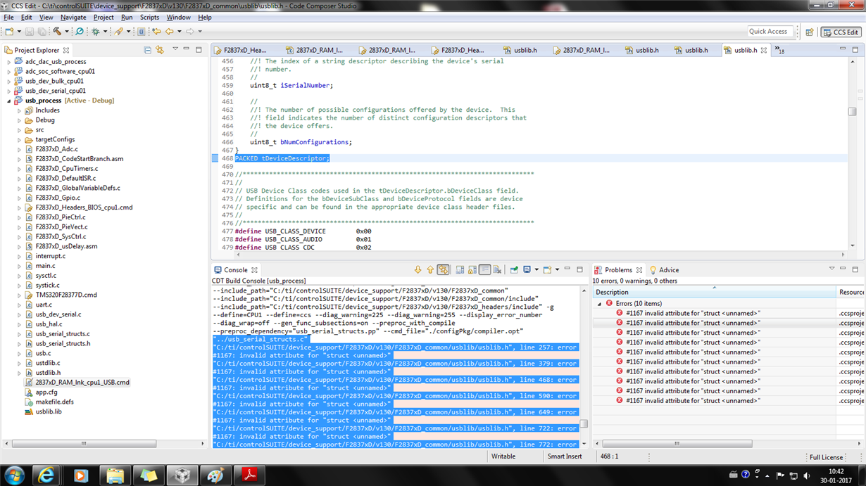

我尝试通过组合控制套件中 TI 提供的 USB_TO_serial 工程来创建 SYSBIOS 工程。
我无法将相应的文件.cmd 添加到映射部分
请帮助您添加文件并构建文件以获取.out 文件
我已附加目录的屏幕截图和我遇到的错误、以便让我知道哪些文件实际上丢失了
--include_path="C:/ti/controlSUITE/device_support/F2837xD/v130/F2837xD_headers/include -g --define=cpU1 --define=ccs --diag_warning=225 --diag_warning=255 --display_error_number --diag_wrap=off --gen_func_subsections=on --preproc_with_compile --preproc_dependency="us_serial_structs="us_serial_file.c"--/configPkg/compiler.opt
"C:/ti/controlSUITE/device_support/F2837xD/v130/F2837xD_common/usblib/usblib.h "、第257行:错误#1167:"struct "
"C:/ti/controlSUITE/device_support/F2837xD/v130/F2837xD_common/usblib/usblib.h "、第379行:错误#1167:"struct "
"C:/ti/controlSUITE/device_support/F2837xD/v130/F2837xD_common/usblib/usblib.h "、第468行:错误#1167:"struct "
"C:/ti/controlSUITE/device_support/F2837xD/v130/F2837xD_common/usblib/usblib.h "、第590行:错误#1167:"struct "
"C:/ti/controlSUITE/device_support/F2837xD/v130/F2837xD_common/usblib/usblib.h "、第649行:错误#1167:"struct "
"C:/ti/controlSUITE/device_support/F2837xD/v130/F2837xD_common/usblib/usblib.h "、第722行:错误#1167:"struct "
"C:/ti/controlSUITE/device_support/F2837xD/v130/F2837xD_common/usblib/usblib.h "、第772行:错误#1167:"struct "
"C:/ti/controlSUITE/device_support/F2837xD/v130/F2837xD_common/usblib/usblib.h "、第846行:错误#1167:"struct "
"C:/ti/controlSUITE/device_support/F2837xD/v130/F2837xD_common/usblib/usblib.h "、第876行:错误#1167:"struct "
>>编译失败
"C:/ti/controlSUITE/device_support/F2837xD/v130/F2837xD_common/usblib/usbcdc.h "、第904行:错误#1167:"struct "
在"../usb_serial_structs.c"的编译中检测到10个错误。
gmake:***[USB_serial_structs.obj]错误1.
'生成文件:./ustdlib.c'
'调用:C2000编译器'
"c:/ti/ccsv6/tools/compiler/ti-cgt-c2000_6.4.2/bin/cl2000 "-v28 -ml -mt --cla_support=cla1 -float_support=fpu32 -tmu_support=tmu0 -vcu_support=vcu2 -include_path="C:/ti/ccsv6/tools/compiler/ti-cgt-c2000_6.4.2/include /ti/controlSUITE/device_support/F2837xD/v130/F2837xD_headers/include -include_path="C:/ti/controlSUITE/device_support/F2837xD/v130/F2837xD_common /configPkg/compiler.opt -include_path="C:/ti/controlSUITE/device_support/F2837xD/v130/F2837xD_common/include - predip_diag=dcp_warning="-subsection_subsection-dcp_subs"-over-dcp_guide-board.cp.cp_subsepdips=dcp.cp.cp_over-buls=dips"-over-guide-board.cp.cp.cp.cp.cp.cp_over-guide-subs=dips=dipt.cp.cp.cp.cp.cp.cp.ips"-over-guide-over-guide-over-guide-over-d.pri-subs=d.pri
"./ustdlib.c"、第1380行(第20列):备注#2614-D:使用--fp_mode=relaxed 为 FP 除法启用 TMU 硬件支持。
'完成的建筑:./ustdlib.c'
gmake:目标`全部'不会由于错误而重制。
****构建完成****

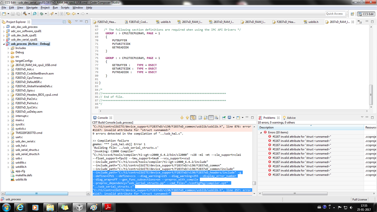

    最后、由于与某些存储器位置的结构映射相关的错误而被卡住添加了屏幕快照和日志、请帮助解决
    >>编译失败
    gmake:***[USB_hal.obj]错误1.
    '构建文件:./usb_serial_structs.c'
    '调用:C2000编译器'
    "c:/ti/ccsv6/tools/compiler/ti-cgt-c2000_6.4.2/bin/cl2000 "-v28 -ml -mt --cla_support=cla1 -float_support=fpu32 -tmu_support=tmu0 -vcu_support=vcu2 -include_path="C:/ti/ccsv6/tools/compiler/ti-cgt-c2000_6.4.2/include /ti/controlSUITE/device_support/F2837xD/v130/F2837xD_headers/include -include_path="C:/ti/controlSUITE/device_support/F2837xD/v130/F2837xD_common /configPkg/compiler.opt -include_path="C:/ti/controlSUITE/device_support/F2837xD/v130/F2837xD_common/include - subsection=usb_warning_diag="-subsection_subs=-cus_suppf-nategrob.cp_display_subs=-builds.combuls=us_subs"-ecnation="-subs=us_display_guids"-ecnature=-subs"-ecnature=g_guids"-=us_guides"-=g.cp.cp.cp.cp.cp.cp.cp_over-fus"-us_display_suppf-nature=us_suppf-nature=us_suppf-us

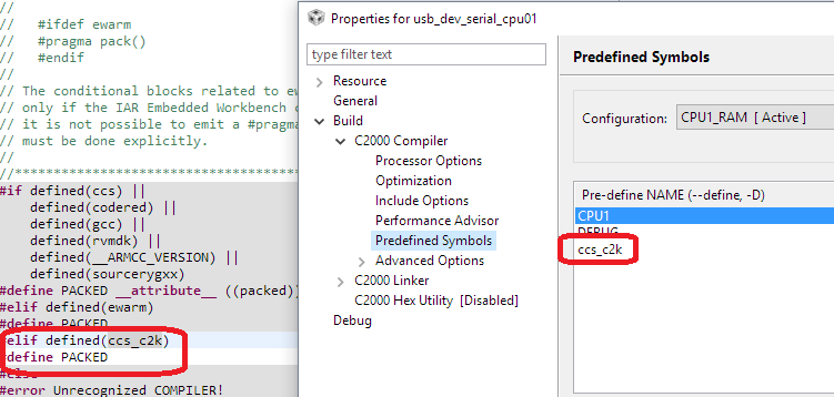

    我怀疑 packed 被定义为__attribute__(((packed),而不是任何内容。 原始 USB 示例通过将 CCS_c2k 放入项目的预定义符号来防止这种情况的发生。 你已经完成了吗?
    惠特尼
    你(们)好
    Whitney 您的建议有效!
