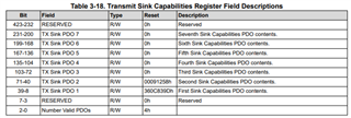

  1. 如何从寄存器0x33计算电压? 例如、使用 TPS25751EVM 从 REG0x33h 读取数据如下所示、PDO1电压和电流设置是多少?
 Reg0x33: 35 04 2C 91 01 10 2C D1 02 00 2C B1 04 00 2C 41 06 00 3C 32 A4 C1 00 00 00 00 00 00 00 00 00 00 00 00 00 00 00 00 00 00 00 00 00 00 00 00 00 00 00 00 00 00 00 00 00 00 00 00 00 00;
