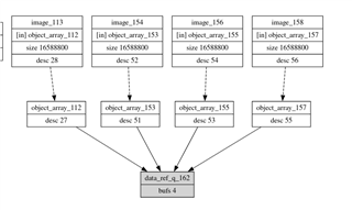

    尊敬的 Chen:
    我检查了图形输出、发现 single_cam_graph_2_pipe_img.txt 中存在一些错误的缓冲区分配
    data_ref_q_159应该由4个图像 object_array 组成、例如第一个缓冲器、其中2、3、4个缓冲器为 image 类型。
    能否将 displaym2mnode 的输出参数设为复制状态、请参阅以下代码
            printf ("Enabling DSS_M2M \n");
            obj->csitx_output_image = vxCreateImage(obj->context, obj->width_in, obj->height_in, VX_DF_IMAGE_UYVY);
            status = vxGetStatus((vx_reference)obj->csitx_output_image);
            if(status != VX_SUCCESS)
                APP_PRINTF("[TEST] fail to create obj->csitx_output_image\n");
            else
                APP_PRINTF("[TEST] success to create obj->csitx_output_image\n");
            obj->csitx_image_arr = vxCreateObjectArray(obj->context, (vx_reference)obj->csitx_output_image, num_capture_frames);
            APP_PRINTF("[TEST] num_capture_frames: %d\n", num_capture_frames);
            status = vxGetStatus((vx_reference)obj->csitx_image_arr);
                APP_PRINTF("[TEST] fail to create obj->csitx_image_arr\n");
            else
                APP_PRINTF("[TEST] success to create obj->csitx_image_arr\n");
            obj->display_m2m_output_image = (vx_image)vxGetObjectArrayItem(obj->csitx_image_arr, 0);
            status = vxGetStatus((vx_reference)obj->display_m2m_output_image);
                APP_PRINTF("[TEST] fail to get obj->display_m2m_output_image\n");
            else
                APP_PRINTF("[TEST] success to get obj->display_m2m_output_image\n");
            obj->display_m2m_param_obj = vxCreateUserDataObject(obj->context, "tivx_display_m2m_params_t", sizeof(tivx_display_m2m_params_t), &obj->display_m2m_params);
            status = vxGetStatus((vx_reference)obj->display_m2m_param_obj);
                APP_PRINTF("[TEST] fail to create obj->display_m2m_param_obj\n");
            else
                APP_PRINTF("[TEST] success to create obj->display_m2m_param_obj\n");
            obj->displaym2mNode = tivxDisplayM2MNode(obj->graph, obj->display_m2m_param_obj, ldc_in_image, obj->display_m2m_output_image);
            vx_bool replicate[] = { vx_false_e, vx_false_e, vx_true_e };  // replicate displaym2m_output so that framework created buffer for the object array, because csitx node uses object array as input
            vxReplicateNode(obj->graph, obj->displaym2mNode, replicate, 3 );
            if(status == VX_SUCCESS)
                status = vxSetNodeTarget(obj->displaym2mNode, VX_TARGET_STRING, TIVX_TARGET_DISPLAY_M2M1);
                status = tivxSetNodeParameterNumBufByIndex(obj->displaym2mNode, 2u, obj->num_cap_buf);
            // CSI-TX
                obj->csitx_node = tivxCsitxNode(obj->graph, obj->csitx_config, obj->csitx_image_arr);
    #if 1
                vxSetNodeTarget(obj->csitx_node, VX_TARGET_STRING, TIVX_TARGET_CSITX);
    #else
                vxSetNodeTarget(obj->csitx_node, VX_TARGET_STRING, TIVX_TARGET_CSITX2);
    #endif
    #endif
    更改后、检查 GRAGE_2输出中的缓冲区。
    Gokul
    尊敬的 Gokul:
    感谢你的帮助。
    我尝试添加您的更改、然后检查了 single_cam_graph_2_pipe_img.txt 文件
    更改有效、如下面的日志所示。
    d_28 [shape=record , label="{image_113 | [in] object_array_112 | size 16588800 | desc 28}"]
    d_27 [shape=record , label="{object_array_112 | desc 27}"]
    d_28 -> d_27 [style=dashed]
    d_51 [shape=record , label="{object_array_153 | desc 51}"]
    d_51 -> d_data_ref_q_162
    d_52 [shape=record , label="{image_154 | [in] object_array_153 | size 16588800 | desc 52}"]
    d_52 -> d_51 [style=dashed]
    d_53 [shape=record , label="{object_array_155 | desc 53}"]
    d_53 -> d_data_ref_q_162
    d_54 [shape=record , label="{image_156 | [in] object_array_155 | size 16588800 | desc 54}"]
    d_54 -> d_53 [style=dashed]
    d_55 [shape=record , label="{object_array_157 | desc 55}"]
    d_55 -> d_data_ref_q_162
    d_56 [shape=record , label="{image_158 | [in] object_array_157 | size 16588800 | desc 56}"]
    d_56 -> d_55 [style=dashed]
    [label=" replicated"]

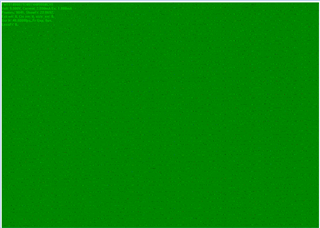

    但当我按下面所示单摄像头应用函数中的"S"来验证 csitx_output_image 时。
    它仍然接收不像全绿色那样的信息图像。

    您能帮我检查剂量它找不到什么错误吗?
    此外还附加  tivxExportGraphToDot 文件以供您参考。
    e2e.ti.com/.../0456.single_5F00_cam_5F00_graph_5F00_1_5F00_img.txte2e.ti.com/.../0456.single_5F00_cam_5F00_graph_5F00_2_5F00_pipe_5F00_img.txte2e.ti.com/.../0456.single_5F00_cam_5F00_graph_5F00_3_5F00_data_5F00_ref_5F00_q_5F00_img.txte2e.ti.com/.../0456.single_5F00_cam_5F00_graph_5F00_4_5F00_pipe0_5F00_img.txt

    您好、Brijesh、
    遗憾的是、我仍然看到  SAVE_DEBUG_IMAGES 函数上的 csitx_output_image 的绿色输出。
    您能帮我检查剂量它找不到什么错误吗?
    YL

    您是否在您的代码中完成了这些更改以保存图像、本质上 DISPLAY_M2M_OUTPUT_IMAGE 和 CSITx_OUTPUT_IMAGE 将是相同的。
    根据最新的图形、正确创建了输出缓冲区、没有问题。
