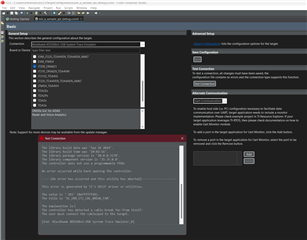

我尝试 在 CCS 12.8.1中将 Blackhawk USB560v2系统跟踪程序调试器(BH-USB-560v2)连接到 J7200 EVM。 CCS 报告的错误#-183。 我在下面附上了屏幕截图和日志。 我的 EVM 设置为无引导模式。 您能告诉我什么问题吗? 我预计该调试器开箱即用、因为 CCS 支持该调试器。
Charles
测试连接日志
[Start: Blackhawk XDS560v2-USB System Trace Emulator_0]
Execute the command:
%ccs_base%/common/uscif/dbgjtag.exe -f %boarddatafile% -rv -o -F inform,logfile=yes -S pathlength -S integrity
[Result]
-----[Print the board config pathname(s)]------------------------------------
C:\Users\rhlchmao\AppData\Local\TEXASI~1\
    CCS\ccs1281\0\0\BrdDat\testBoard.dat
-----[Print the reset-command software log-file]-----------------------------
This utility has selected a 560/2xx-class product.
This utility will load the program 'bh560v2u.out'.
Loaded FPGA Image: C:\ti\ccs1281\ccs\ccs_base\common\uscif\dtc_top.jbc
The library build date was 'Sep 26 2024'.
The library build time was '10:02:16'.
The library package version is '20.0.0.3178'.
The library component version is '35.35.0.0'.
The controller does not use a programmable FPGA.
An error occurred while hard opening the controller.
-----[An error has occurred and this utility has aborted]--------------------
This error is generated by TI's USCIF driver or utilities.
The value is '-183' (0xffffff49).
The title is 'SC_ERR_CTL_CBL_BREAK_FAR'.
The explanation is:
The controller has detected a cable break far-from itself.
The user must connect the cable/pod to the target.
[End: Blackhawk XDS560v2-USB System Trace Emulator_0]
    仅供参考、板载 XDS110调试器没有此连接问题。 EVM 上的 SW3.2处于 ON 位置。 我的定制电路板存在相同的连接问题、因此我想先在 EVM 上进行验证。
    也请访问:-> https://e2e.ti.com/support/processors-group/processors/f/processors-forum/1178240/faq-sk-tda4vm-how-do-i-connect-the-external-debugger-blackhawk-usb560v2-xds560v2-usb-system-trace-to-the-jtag-on-the-board
    谢谢。
