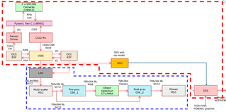

尊敬的 TI 专家:
我将根据"app_tidl_avp4"创建一个自定义应用、并进行了以下两项更改:
  1. 将显示输出更改为 SRV
  2. 将 TIDL 从 SEG 更改为 OD
这种变化导致了整个图的性能下降、现在大约为20fps。
GRAPH: custom_app_graph (#nodes =  11, #executions =  39722)
 NODE:       CAPTURE1:             capture_node: avg =   1622 usecs, min/max =    154 /  61714 usecs, #executions =      39722
 NODE:     VPAC_VISS1:                viss_node: avg =  18505 usecs, min/max =  17735 /  24338 usecs, #executions =      39722
 NODE:         MCU2-0:                aewb_node: avg =    455 usecs, min/max =    154 /  65242 usecs, #executions =      39722
 NODE:      VPAC_LDC1:                 ldc_node: avg =  16601 usecs, min/max =  13899 /  24016 usecs, #executions =      39722
 NODE:      VPAC_MSC2:              scaler_node: avg =  26454 usecs, min/max =  21934 /  33801 usecs, #executions =      39722
 NODE:          DSP-1:              PreProcNode: avg =   3554 usecs, min/max =   3328 /   4447 usecs, #executions =      39722
 NODE:       DSP_C7-1:                tidl_node: avg =  49816 usecs, min/max =  47580 /  54819 usecs, #executions =      39722
 NODE:          DSP-2:    DrawBoxDetectionsNode: avg =  14447 usecs, min/max =   8209 /  19117 usecs, #executions =      39722
 NODE:      VPAC_MSC1:              mosaic_node: avg =  16820 usecs, min/max =   3871 /  84152 usecs, #executions =      39722
 NODE:          MPU-0:          OpenGL_SRV_Node: avg =  15226 usecs, min/max =  11878 /  46502 usecs, #executions =      39722
 NODE:       DISPLAY1:              DisplayNode: avg =   8845 usecs, min/max =    106 /  33199 usecs, #executions =      39729
 PERF:           FILEIO: avg =      0 usecs, min/max = 4294967295 /      0 usecs, #executions =          0
 PERF:            TOTAL: avg =  49885 usecs, min/max =  32556 /  74620 usecs, #executions =      17449
 PERF:            TOTAL:   20. 4 FPS
我认为、通过将图形分为两个、一个用于 SRV 侧、一个用于 OD 侧、我可以提高性能。(下图中的红色和蓝色区域)
但将图形拆分为两并没有提高性能。
GRAPH: custom_app_graph1 (#nodes =   5, #executions =    296)
 NODE:       CAPTURE1:             capture_node: avg =  13394 usecs, min/max =    166 /  59766 usecs, #executions =        296
 NODE:     VPAC_VISS1:                viss_node: avg =  19128 usecs, min/max =  17962 /  20964 usecs, #executions =        296
 NODE:         MCU2-0:                aewb_node: avg =    310 usecs, min/max =    156 /   1371 usecs, #executions =        296
 NODE:          MPU-0:          OpenGL_SRV_Node: avg =  11470 usecs, min/max =  10603 /  44925 usecs, #executions =        296
 NODE:       DISPLAY1:              DisplayNode: avg =   9912 usecs, min/max =     89 /  16342 usecs, #executions =        296
GRAPH: custom_app_graph2 (#nodes =   6, #executions =    148)
 NODE:      VPAC_LDC1:                 ldc_node: avg =  14735 usecs, min/max =  13905 /  15450 usecs, #executions =        148
 NODE:      VPAC_MSC2:              scaler_node: avg =  23128 usecs, min/max =  20792 /  24294 usecs, #executions =        148
 NODE:          DSP-1:              PreProcNode: avg =   3243 usecs, min/max =   3108 /   3427 usecs, #executions =        148
 NODE:       DSP_C7-1:                tidl_node: avg =  45332 usecs, min/max =  41988 /  48336 usecs, #executions =        148
 NODE:          DSP-2:    DrawBoxDetectionsNode: avg =   7428 usecs, min/max =   7023 /  13685 usecs, #executions =        151
 NODE:      VPAC_MSC1:              mosaic_node: avg =   4696 usecs, min/max =   3857 /  29426 usecs, #executions =        151
 PERF:            TOTAL: avg =  50167 usecs, min/max =     20 / 188239 usecs, #executions =        304
 PERF:            TOTAL:   19.93 FPS
我的目标是让 SRV 以30fps 运行、OD 以15fps 运行。 您能给我一些建议、我该如何实现这个目标吗?
Daigo

    尊敬的  Christina:
    我附加了 一个 自定义 avp4演示的补丁。  我不熟悉 OpenVX 或者如何使用图形参数、因此双图形调度可能是错误的。 我最想实现的是将 SRV 保持在30fps、并且我希望检测以较低的频率异步运行。
    Daigo
    e2e.ti.com/.../1780.custom_5F00_avp4.zip

    尊敬的 Daigo:
    是的、我理解您的用例、但我们不能使图形异步运行、替代方法是对交替帧排队、这样会产生15fps 的帧、但如果您希望第二个图形的帧具有不同的 fps、则应用程序应该具有使适当帧排队/出队以实现 fps 的逻辑。
    不管怎样,一旦你得到补丁15 fps 你会得到一个想法的其余。
    Gokul
    尊敬的 Gokul:
    > 但我们不能使图形异步运行
    我不确定我是否理解正确、但这是排队/出队逻辑施加的限制吗? 我希望 SRV 保持至少30fps (无论 OD 性能如何)。
    无论哪种方式、我都会等待您的更新。  感谢您的合作。
    Daigo
    尊敬的 Daigo:
    应用 vision_apps 文件夹中的补丁、
    e2e.ti.com/.../avp4_5F00_15_5F00_30_5F00_fps.patch
    这将以30fps 的速率运行 srv、以15fps 的速率运行分割模型。
    Gokul
    尊敬的 Gokul:
    感谢您的补丁!
    当然,你的补丁工作正常,我有一个更好的理解双 图形的排队/出队逻辑.
    在此基础上、我们将开始实施自定义应用。 感谢您的慷慨支持!
    Daigo
